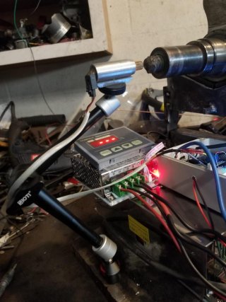

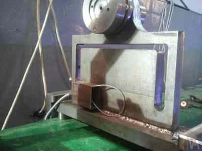

I've always wanted to build a balancing rig like this And finally the stars aligned and made thoughts into matter.
The physical construction is pretty self-explanatory in the images. As for the electronics I'm using a pair of 20 kg load cells that I pulled out of a pair of handheld digital scales I purchased from Amazon for $9 each. Those sensors are tied into an x1000 gain amplifier and fed into a teensy 4.0. I'm also using a magnetic rotary angle position sensor which has a 3.3 volt power input and analog output from 0.3 volt to 2.8 volt over a 360° rotation.

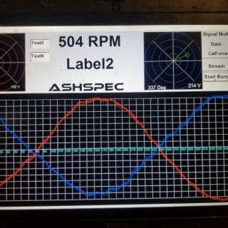

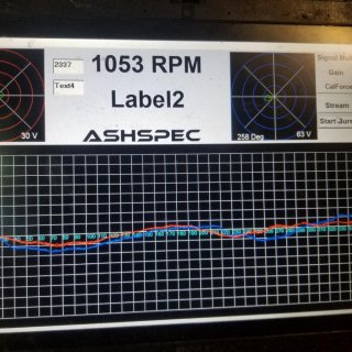

The teensy has two different operating modes: stream and burst. Streaming mode samples position and load cells and spits that data out through the serial port as quickly as it can crunch. This is mostly used just for making sure the position sensor and load cells are working properly. Burst mode writes out to two separate arrays of 10x360 where load cell data is stored for each degree of rotation. Then the average is taken over those 10 samples for each degree. This process is performed over 150 revolutions and each degree averaged once again. At that point serial data is sent to the PC to cover one full rotation of load cell data.
The windows UI is written in VB6 and is pretty self-explanatory. At the moment it is at its most basic it can functionally be but I couldn't be happier with the results.
I've attached a link to a YouTube video I put together today of it as a walkthrough. I have quite a few more code implementations to write up but now having a functional machine has really helped to fuel the motivation. 😏

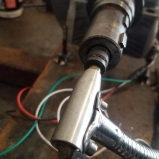

The position sensor only provides the angular position of the crankshaft. The two load cells, one on each pedestal, provide the force data created by the imbalance of the part.
In burst mode the teensy first begins continuous analog reads from the position sensor until the crankshaft is at 0°. This is while the crankshaft is rotating at speed. As soon as the crank is at 0°. That kicks off a sub routine which reads the ADC values from the two load cells. This data from the load cells is acquired over seven samples which is averaged. There are two separate arrays, one for each load cell, 10*360. So at this first burst sample cycle here at 0°, The value of the load cells is put into position zero, zero in each of the two arrays.
Then the burst routine waits until the crank rotates to 1° and that kicks off the force measurement routine. That populates the two arrays in positions zero, one.
It does this over a full 360° rotation and then continues that same process for nine more full rotations. This populates both force arrays.
That kicks off a simple averaging routine that averages the force data over those 10 rotations for every single degree and puts those average values into another array for storage temporarily.
On top of the 10 rotation data average I've set the code up to do this 15 times over. This was needed to filter out both mechanical noise affecting the load cells AND the jitter in the teensy's ADC (GRRRR).
At this point a subroutine kicks off to send 360 load cell data points for the front sensor and 360 load cell data points for the rear sensor, using the serial print function. On the receiving side the windows UI populates two different arrays with load cell data. Because each array begins at 0° position that makes it pretty easy to manage the data and use that for generating the graphical display.

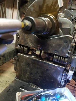

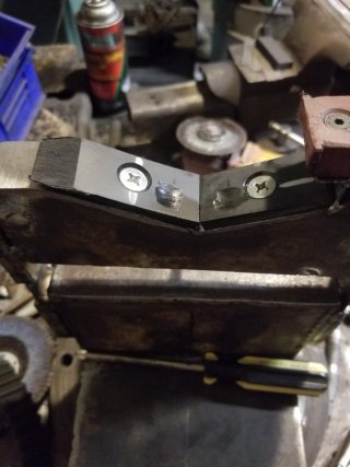

I've ordered delrin acetal plastic plate to make a set of v-block supports for the crankshaft rather than using rolling element supports. Ball bearings are just inherently mechanically noisy not to mention the kind of precision machine work it took to produce the sleeves the bearings are pressed into and the shafts that are pressed into the bearings such that the interference fit of both of those components properly loaded the ball races to eliminate the ball slop AND that the roller plates were perfectly concentric, square and true to the bearing centerline.
Delrin v blocks we'll have a very low coefficient of friction on the steel main journals and better yet it will completely eliminate all rolling element mechanical noise and potential mechanical runout.
Eliminating those heavy bearings and shafts will also be beneficial. The additional mass dampens the effect of imbalance in the rotating part so the lighter you can make the support pedestal the better... Not to mention it also increases the base resonant frequency of the pedestal/part assembly.

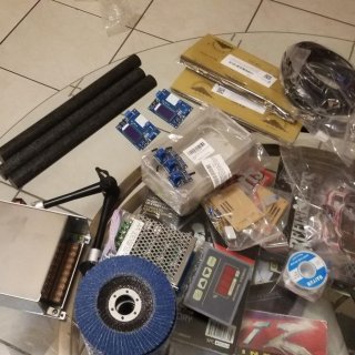

I love Amazon! At 6:00 a.m. this morning I ordered a bunch of trick parts for the balancing machine. All of the pieces arrived a couple of hours ago, on a Sunday, on the same day I ordered them! How wonderful of a world we live in today!
Delrin acetal rod to machine flat bearing pads for the support pedestals.
24V 50A power supply for the juice to run it all.
30A PWM DC motor speed controller.
Adjustable voltage regulators with digital display for 5v and 3.3v source.
Instrumentation amplifiers for the load cells with adjustable gain and adjustable zero offset.
Articulating adjustable arm for position sensor mounting.

To make sure that I'm operating below resonance I have connected my oscilloscope to the load cells and in a crude but effective method, if you just tap each end at the pedestal without the crank rotating it will cause the pedestal to resonate. With the current plate spring and load cell arrangement and with this crankshaft in place the pedestals are resonating at 35Hz.
I have changed the pedestals and eliminated the ball bearings and have gone to delrin acetal v-block pad bushings. So now the upper support pedestals are a bit lighter than before so that natural resonance will have gone up. I plan to check that here in the next few hours when I get back on the project.
I will end up writing into my interface a simple routine that will analyze the load cell signals to determine the resonant frequency of the pedestals without having to use another piece of electronics. I'm also thinking that for heavier items obviously The support hardware will need to be stiffer in order to maintain a decent high enough resonant frequency so I've contemplated either installing springs with adjustable preload or making it so that additional spring plates can be installed.
If you look in the original pictures of this post at the waveform graph at 1053 RPM you can see how there's a double heavy spot within one rotation. At 1,053 RPM that puts you right at 17.5 Hz rotational frequency which is 1/2 of the pedestal support frequency. The small amount of imbalance in the crank that remained at that point was exciting that natural pedestal frequency being right at 2x the rotation speed.
Surprisingly enough, at this point in the balancing process I was able to trim the imbalance down to within 1 g at the front end of the crank and 1.7 g at the back end. The entire crank assembly with bob weights has a total mass of 52 lb.. or 23,587g. It's still quite astonishing that I was able to get the imbalance so incredibly low compared to the total mass of the part being balanced. And that was on the first shot with a hardware configuration that created a lot of mechanical noise that had to be filtered. This new arrangement with the solid acetyl bearing pads and going from 20 kg load cells to 5 kg load cells will definitely improve the signal range per mass and get rid of all the noise. I'm thinking the new setup will be able to consistently measure down into the +/- 0.05g accuracy range.
Now that I've gone to these solid acetyl bearing pads all of the noise induced by the rolling element bearings has been eliminated. As a result I shouldn't have to use as much signal filtering/averaging to clean up the waveforms which ultimately will produce a much greater ability to measure the imbalance. Because of that I also shouldn't have to spin the part as quickly to get enough amplitude to resolve a decent signal. I should have everything up and going here within the next few hours and be able to post back the results with the new upgrades.

A variety of kibbles and bits were ordered for the balancer.
24V 50amp power supply.

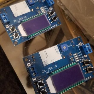

Precision adjustable voltage regulators with both voltage and amperage display.
Delrin acetal copolymer rods.
Instrumentation amplifiers (for load cells) with variable adjustable gain (up to 1000x) AND with adjustable zero offset.
12" adjustable articulating arm for mounting the magnetic angle position sensor.
PWM adjustable motor speed controller for the drive motor.
5Kg load cells

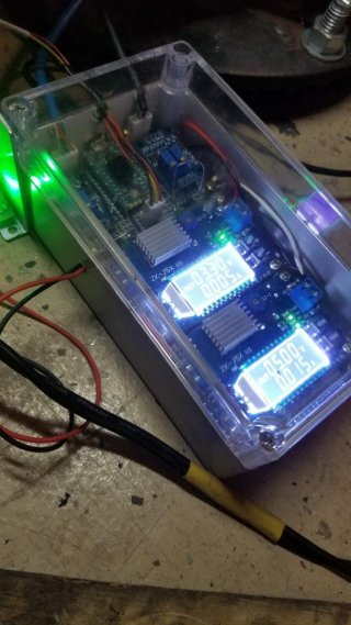

And a handsome see-through electronics enclosure.
The voltage regulators, instrumentation amplifiers, and the Teensy 4.0 microcontroller were all integrated onto a common circuit board built to fit inside of the enclosure. Quick disconnect connectors were used for the sensors.
I did away with the ball bearing roller configuration in the balancer stanchions and fabricated a pair of steel upper pedestals. These pedestals have a pair of 30° faces to form the v-block. The Delrin rods were machined into flat bushings and mounted to the upper pedestals.
The coefficient of friction between delrin and polished steel is about 0.2 which is impressive in itself. But with the addition of some high viscosity gear oil (90w) that interface is slick as snot. I was going to use PTFE (Teflon) originally but unfortunately that material is just too soft. Not only would it wear very quickly but it would also tend to dampen the vibration a little bit, although probably insignificant.
Once everything was fabricated and I ran a few test spins it was very clear that these 5 kg load cells just do not offer enough rigidity in the suspended pedestals. The natural harmonic frequency significantly dropped down from 35Hz to 7Hz from using the 20 kg load cells. My solution was to incorporate a pair of Nissan valve springs into the pedestals to increase the rigidity within the suspension. This was convenient as they were perfectly sized and using the valve spring retainers at each end made it a nice clean installation. I integrated stainless Allen head screws with machined tapered arbors on their ends to match the profile on the spring retainers to provide easy adjustability of the preload. This worked perfectly.
In the process of balancing another crankshaft the adjustable suspension preload system revealed that it was not just a solution to a problem. Rather, it was a significant upgrade! Being able to adjust the stiffness of the pedestal suspension provides a means to stiffen it up for initial rough balancing and then reduce the preload to improve the load cell response for fine balancing. This also gives way to incorporating a "soft bearing" balancing approach where the part is spun up higher than the suspension resonance. This would be a hybrid of the two balancing strategies given that soft bearing systems measure displacement rather than force. But fundamentally the only difference is in the phase shift so that would be interesting to study. Soft bearing systems always operate at higher rotating speeds which increase the imbalance forces; effectively increasing the sensitivity of the balancer.
In addition to all of this I also rewrote the data acquisition code. Previously I was waiting until degree zero, read from the load cells, then wait for degree 1, read the load cells, wait for the degree two, and so on.
Unfortunately this method just isn't very efficient for reading load cell data at maximum sample rate.
The new code waits for the crankshaft to come up to test speed, then measures the time for one full rotation. Then it immediately kicks off high speed sampling of the left load cell at 380,000 samples per second for the duration of time it took for the previous 360° of rotation. At the end of the second rotation it kicks off sampling of the right hand load cell for the next 360°. At 500 RPM it only takes about 0.12 seconds for one revolution so in that time I'm now collecting about 45,000 samples from each of the load cells compared to only 360 samples in the previous method. With this kind of sample resolution it opened the door for implementing some digital signal processing. I assembled an algorithm which uses a third order Butterworth low-pass filter with a cutoff frequency at 25 Hertz.
The load cells are incredibly sensitive which is great for picking up even the smallest amount of imbalance but not so great in that they pick up all of the other noise within the machine. I haven't done an FFT to see what the spectrum looks like but on the same token it's not really necessary. I know that I only want frequencies below the pedestal resonance and in that case the most predominant signal there is due to imbalance. Implementing this low pass filter made the signal data absolutely night and day difference compared to without it. The imbalance signal is smooth as a baby's butt.
The only caveat to using a third order Butterworth is signal lag which was quite evident. At 500 RPM the signal log was hovering around 25° or so. In order to compensate for this I tapped back on my study of Empirical Mode Decomposition. I already had all of the core coding written to do this so I punched it up and gave it a run. What I discovered is that the EMD process by itself produced exactly the result I was looking for.
Given that EMD is based within the time domain, that approach filtered out all of the different frequencies without any lag. And on top of that due to the fact that the frequency I'm most interested in is the lowest of all the frequencies within the system, this frequency will always be the last IMF (intrinsic mode function) in the decomposition process.

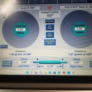

Lastly, once I finished balancing this second crankshaft I wanted to get an idea of the sensitivity of my machine. So I placed a 0.75 g neodymium magnet on the front counterweight and spun her up. With the spring suspension at its softest that little amount of mass was producing load cell data that spanned about 50% of the y-axis on the graph.
At this point the machine is perfectly capable of balancing all the way down to 0.1g.

Not sure that the bearing support pedestals are directly responsible for the 32Hz resonance but more the overall structure including what it's bolted to.
Thinking on it took me back to the late 1970s and loud music played on yes, Vinyl disks, ploughed with a kind of load cell. To stop his tonearm/plough skipping when the volume was cranked up(plenty of Bass) one colleague sawed a hole in his timber floor and inserted a concrete footing and pedestal for the turntable. Over time the speakers got better which exposed turntable platter and tonearm resonance. Thankfully the advent of compact disks averted further frivolous engineering.
Wonder if it might have more to do with the concrete slab.

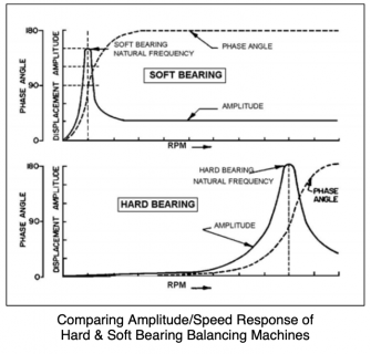

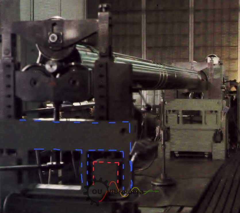

I would like to share some thoughts on the use of different types of sensors in balancing machines.
If I have considered everything correctly, you make a soft bearing balancing machine with supports on flat (plate) springs. Frequency of natural oscillations of these supports should be at least 2-3 times lower than the rotational frequency of the balancing rotor, which is mounted on them.
I think that for soft bearing machines application of capacitive accelerometer ADXL 335 would be more appropriate.
Tenso sensors, on the other hand, will experience overloading. A hard bearing support would be more suitable for these types of sensors.
For example :
Due to the difference in stiffness between the blue and red parts of the support, you will receive a signal from the strain gauge.
