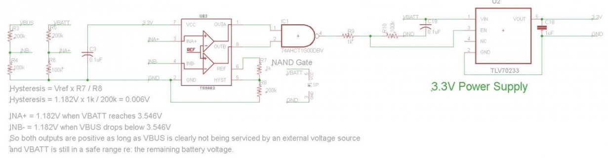

However, would it be OK for them to be both feeding the same 3.3V bus if one of them is about to drop out due to a rapidly decreasing power supply? I ask, since I would like to use the enable feature on a voltage regulator with a dual comparator to detect when 1) the main supply bus voltage has dropped 30% and 2) the battery has enough juice left. I am using a TS9002 comparator. Here is the circuit I propose using for the battery-powered supply.
The VBUS power supply is at a nominal 5V. The drop-out voltage on these TLV70233 regulators should be on the order of less than 100mV in my application. VBATT is hooked up to a LiOn battery and that voltage should range from 4+V to about 3.6V when the thing is empty. I used a NAND gate to combine the two outputs and drive the input into the TLV70233 Enable Pin HIGH whenever the two conditions above are met and the two outputs out of the dual comparator are LOW.
The idea is that the TS9002 will sense the rapidly decreasing VBUS voltage (let's say the power plug is pulled on the wall wart) and as the bus voltage plummets past 3.5V, the battery power supply is enabled. A pull-down resistor will pull the Enable Pin on the TLV70233 down as soon as the NAND gate no longer supplies a HIGH signal.
For the short time that the two voltage regulators are potentially at odds with each other, would you expect any damage? I'd think the time period would be too short and the disconnects too infrequent for this to be an issue, but is this correct?
