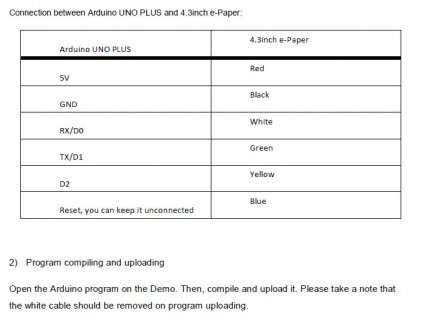

Well, I have had my Waveshare 4.3 inch e-paper display for 24 hours now and have had it working (on Arduino Uno) for the past two hours with different sketches to learn the commands and capabilities. Given the lazy refresh I am very impressed with the contrast and definition of the display. I can live with the slow refresh.
BUT, I can't get this display to work with my various Teensy 3.2 units.
At this time I am stumped. I have tried connecting to the Teensy digital pins 0 (for Rx) and 1 (for Tx) with no luck and have then tried digital pins 11 for Dout and 12 for Din.
Any help would be greatly appreciated (as usual, thank you very much to the forum for all the help in the past too!).
I have used the same pinouts as required by the manual and which worked on the Uno. These are:

The problem is within epd.cpp. It's sending to "Serial".
static void _putchars(const unsigned char * ptr, int n)
        int i, x;
        for(i = 0; i < n; i++)
            x = ptr[i];
                Serial.write(x);
On Arduino Uno, there's only one Serial.
On Teensy, there are several. Serial communicates to the USB serial. Serial1 communicates with pins 0 & 1. When you run this, it's sending the data to your PC, not the display. If you select the correct port in Serial > Ports, and then open Arduino's serial monitor, you should see the data which was meant to be sent to the display.
To make this work on Teensy, you need to edit all the "Serial" to "Serial1" within that code.
Hello Paul. Thank you for your help and your very clear explanation. Although I had actually tried this sometime in the early morning today an other issue prevented the sketch from working at that time.
I went back to the original files from Waveshare and did this minor edit as you described and all my e-paper sketches now not only compile but they run as they should.
Thank you.
