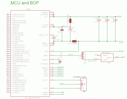

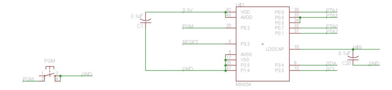

FWIW, I have updated the above file a bit to simplify the drawing a bit. Here is a sample with the MCU in one window and the bootloader in another.
MK20DX256 MCU:
Note: The 4.7k pullups on the SDA and SCL lines (A4/A5) are missing (were elsewhere in drawing). Also, I do not connect the VREF pin to VCCA like Paul does via a 470 Ohm resistor. I like using external series references, when necessary.
TQFP Bootloader
And yes, I am aware that some of the ceramic caps on the schematics are inverted/improper (ceramic caps are bipolar). Not sure how I missed that earlier. :p
Lastly, you will need to add a USB interface of choice, along with 33 Ohm resistors on D+ and D-. Don't forget to ground the USB case via a ferrite like Paul does.
