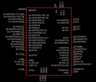

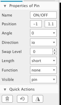

I noticed that in the schematic symbol it shows the name of the pin inside the box and outside as well. I changed this so that it's only inside the box.... Pin Visibility = Pin (instead of Both).
Visibility = Both
Visibility = Pin
Mehow, Thanks.. Your input gratefully accepted. I was so worried about getting things in the right place I didn't notice the dual names.

You have the Ethernet pins starting at a Y coordinate of 0.0983" away from the side pins. I think that should probably be 0.1". (Or 0.15" from the closest edge.)
Your symbol is very crowded. I could not find pin 0 or pin 1. (The descriptions overlap with other pin descriptions.) Maybe put the "inside pins" like Ethernet and USB into groups away from the regular pins?
This is what I'm working on right now. This omits the VUSB because it's not on the information card that came with mine. (Neither are the other interior pins but the VUSB escaped me until I was putting my T4.1 down on the printout to check the pins.)
Morgan, thanks for your reply...
On my screen I don't have any description overlaps on the symbol diagram(?)
Pin 0 and pin 1 on the symbol diagram are on the right below the USB connections.
Pins 0 and 1 are "0-RX1/CS1/CRX2" and "1-TX1/MISO1/CTX2" and
they are grouped together with the other RX/TX combinations in sequence.
Grouping on the symbols might be different for the different needs of each board design. On my boards I have all of my ADC
inputs coming from connectors on the left of the Teensy. I also prefaced the description of the pin functions with the actual pin number(ie. "25-A11/RX6/SDA2") for clarity.
Usually, when designing a symbol diagram I usually leave spaces between functional groups, but on larger symbols I might omit the spaces in trying to save space on my schematic drawing. Also, I always put the power inputs at the top, grounds at the bottom, inputs to the left and outputs to the right. I find this works best for me for the proper overall flow in the schematic.
I especially liked the way you annotated the ethernet pins and I hope you don't mind, but I incorporated your idea into the next update to my symbol design.
The footprint does have a lot of little pin description overlaps and is quite busy, but that helps me to proof the traces as I am laying out the board. Sometimes while laying out traces, the extra verbage on the board drawing helps me to find a better pin/trace configuration that works better on the board.
On the footprint, the offset from the ethernet pins to the side pins or board edge could be slightly wrong because of my poor measuring capabilities. I will try to do a more accurate measurement and update the library as needed.
Thanks again for your much appreciated input.
This is what I see...
But I'm on an old version of Eagle (7.5.0) so maybe that makes a difference in the text size.
Looking at mine again, I also added "USB Host" next to the USB pins.
I actually have a couple of different footprints with or without the interior pins, so they have different symbols. There is a school of thought which says your schematic symbols should exactly copy the physical pin layout on the part. The theory is that if you do have requirements like keeping digital away from analog, you can see that split on the schematic as well as on the PCB. I don't fully subscribe to that but I do try to make my Teensy/Arduino symbols look a little bit like the actual part - in this example pin 32 and 33 are opposite each other at one end.
Yes, the usb and ethernet pins in the library are in the correct location per Paul.
I try to avoid kitchen sink symbols so I set up the USB Host and ethernet headers as separate symbols.
