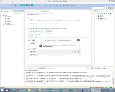

I installed EXACTLY as per instructions - Arduino IDE 1.52 Beta, Eclipse June SR2 + Arduino plugin as instructed. Then loaded a sample project for the CC3000 wireless module and the Teensy 3. Once I got the libraries figured out and refreshed the project, I ended up with one error:
Description Resource Path Location Type
make: *** [arduino/HardwareSerial1.cpp.o] Error -1073741502 C/C++ Problem
Then, when I went to run the Arduino/Verify command and got this error:
arm-non-eabi-g++.exe Application Error
The application was unable to start correctly (0xc0000142). Click OK to close the application
Just in case, I am using Win 8.1 x64.

Good point! I had tested extensively with IDE 1.05 but not 1.52. So I first compiled blink with the IDE 1.52 without errors. Then I created a project in Eclipse and copy/pasted the blink code to the project and tried to verify it. This is what I get:
Any thoughts?
It looks to me that the arm-none-eabi.exe simply crashes. I would suggest you post this in the Plug in specific Arduino forum thread HERE.
There may be more Windows users around there that have encountered this. Also Jantje the Author of the Plugin frequently answers posts there and may be able to help you. Although he's a Linux guy ;-)
Great! So the solution was pretty straight forward based on Deiter-W's comments. I had just installed Arduino IDE 1.5.5 and copied "msys-1.0.dll" in hardware/tools/avr/utils/bin over to the same directory in the IDE 1.5.2 setup to work with Eclipse and VOILA! Now if the plugin can be updated to work with 1.5.5.... :)
