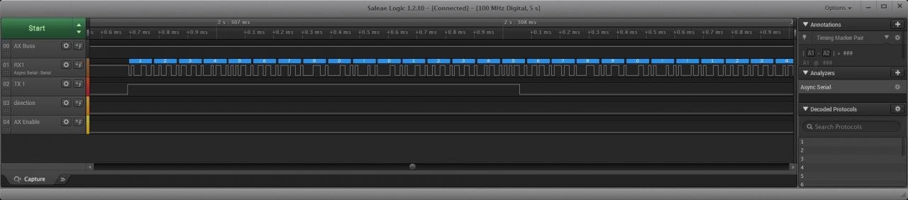

Blink Simple Sample of HSRUN EEPROM WRITE
This is a Blink Simple Sample of writing the EEPROM - even on the T_3.6 while over 120 MHz. The prior code shows evolving test code to develop and see it work.
// #include "EESpeedDHR.h" // THIS FILE
// ------------------- COPY BELOW THIS TO YOUR CODE
The following allows writing to EEPROM at HSRUN speeds on T_3.6,
it compiles out when not T_3.6 or under HSRUN speeds
USAGE:
[B] HSRUN_DROP_BLOCK( ) { // DO NO I/O in this block
EEPROM[ 0 ] = 5; // YOUR CODE HERE
}[/B]
