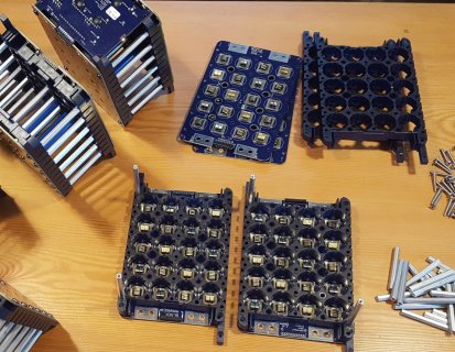

First of all, I'd like to thank all of the forum members, and especially Paul S. for all of the amazing ideas, code and work product that is available on this forum to the greater world, and of course for the great Teensy product line. I've stood on your shoulders to produce a new Teensy LC and 3.2 based (20 - 18650 cell) battery block kit for electric vehicles that I call DKblock, that has uses gold plated phosphor bronze spring contacts for a compression cell connection, and is capable of 100A discharges. I'm using nRF24L01 for wireless communications to get rid of the common BMS problem of bad or loose small wire connections. I'd be happy to post the data sheet on the web or send to anyone interested. Below is a picture I uploaded of the basic components of the kit.

Here is the DKblock kit part picture:

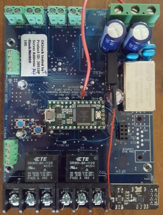

And a picture of the 'Pack Supervisor':
