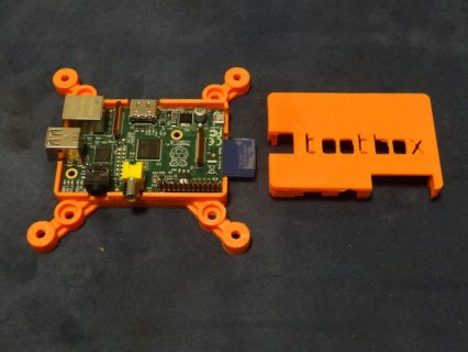

3d printed case
Hi, I just finished printing one of these
for a fellow at Buffalo Lab.
It came out pretty good but the draftsman who made the .stl file was obviously an expert.
That's where the hard part is. It snapped together perfectly!
https://www.thingiverse.com/thing:202959
