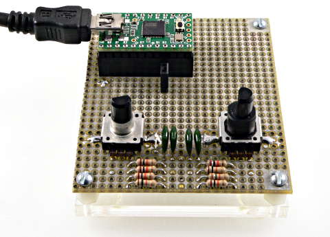

I just tried running your program on my Encoder library board. It's this exact board, except I plugged a Teesny3 into the socket.
I had to make a couple small edits to your program. I don't have that motor library, nor the motor, so I commented it out. My board has the encoder on the left side connected to pins 1 and 2, so I edited the pin numbers. These encoders are 24 pulses/rev, and the Encoder library uses 4X counting, so I changed "M1Distance" to 96. The exact code I ran is attached below.
I turned the encoder 3 revolutions. Here is the output:

It printed each group of lines as I passed the starting position.
On thing to notice is the two counts show more than 48 changes. This particular encoder I'm using has mechanical chatter. The Encoder library very reliably counts 96 for each revolution. But just looking for changes will triple count some events, because the contact chatter.

The 1k ohm resistor on both channels solved the signal problem. It sucks that ARM made this chip 3.3v since most commercial products operate at 5+ volts. Are there any plans to bump up the voltage tolerance of the pins? Otherwise, I have to pay someone to put resistors on every single one of these things if I decide to go this route.
