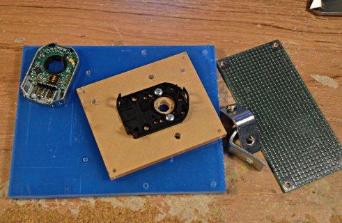

After you've tried it, come back and let me know how it worked for you. Otherwise, I'm not interested in your opinion how easy it is.If you need a 5V to 3.3V level conversion, there are many ways to deal with that very common requirement, not all of them needing an IC. Also if the encoder is too far away from the chip, you'll need line drivers - for example the CUI-10XE-10 includes that. I mean come on, this is very basic stuff that everyone has to deal with, what is the big complaint?
The problem I had with Teensy 3 was that I could never get the pulse current from the encoders right. The closest I have come so far is with a 619ohm resistor on both channels. Even that is subject to source voltage changes. Paul said he used 4.7k ohm resistors in his demo video.
