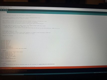

New Error... Please help

Arduino: 1.8.16 (Windows 10), TD: 1.58-beta2, Board: "Teensy 4.0, Serial, 600 MHz, Faster, US English, Normal"
Here are my New Errors:
C:\Program Files (x86)\Arduino\tools\audio-guestbook-main\audio-guestbook\audio-guestbook.ino:49:15: warning: missing terminating ' character
49 | AudioPlaySdWav' playWav1; // Play 44.1kHz 16-bit PCM greeting WAV file
C:\Program Files (x86)\Arduino\tools\audio-guestbook-main\audio-guestbook\audio-guestbook.ino:49:15: error: missing terminating ' character
C:\Program Files (x86)\Arduino\tools\audio-guestbook-main\audio-guestbook\audio-guestbook.ino:50:29: error: expected initializer before 'queue1'
50 | AudioRecordQueue queue1; // Creating an audio buffer in memory before saving to SD
C:\Program Files (x86)\Arduino\tools\audio-guestbook-main\audio-guestbook\audio-guestbook.ino:54:28: error: 'playWav1' was not declared in this scope
54 | AudioConnection patchCord3(playWav1, 0, mixer, 1); // wav file playback mixer
C:\Program Files (x86)\Arduino\tools\audio-guestbook-main\audio-guestbook\audio-guestbook.ino:57:37: error: 'queue1' was not declared in this scope
57 | AudioConnection patchCord5(i2s2, 0, queue1, 0); // mic input to queue (L)
C:\Program Files (x86)\Arduino\tools\audio-guestbook-main\audio-guestbook\audio-guestbook.ino: In function 'void loop()':
C:\Program Files (x86)\Arduino\tools\audio-guestbook-main\audio-guestbook\audio-guestbook.ino:185:7: error: 'playWav1' was not declared in this scope
185 | playWav1.play("greeting.wav");
C:\Program Files (x86)\Arduino\tools\audio-guestbook-main\audio-guestbook\audio-guestbook.ino: In function 'void startRecording()':
C:\Program Files (x86)\Arduino\tools\audio-guestbook-main\audio-guestbook\audio-guestbook.ino:282:5: error: 'queue1' was not declared in this scope
282 | queue1.begin();
C:\Program Files (x86)\Arduino\tools\audio-guestbook-main\audio-guestbook\audio-guestbook.ino: In function 'void continueRecording()':
C:\Program Files (x86)\Arduino\tools\audio-guestbook-main\audio-guestbook\audio-guestbook.ino:297:7: error: 'queue1' was not declared in this scope
297 | if (queue1.available() >= NBLOX) {
C:\Program Files (x86)\Arduino\tools\audio-guestbook-main\audio-guestbook\audio-guestbook.ino: In function 'void stopRecording()':
C:\Program Files (x86)\Arduino\tools\audio-guestbook-main\audio-guestbook\audio-guestbook.ino:329:3: error: 'queue1' was not declared in this scope
329 | queue1.end();
C:\Program Files (x86)\Arduino\tools\audio-guestbook-main\audio-guestbook\audio-guestbook.ino: In function 'void playAllRecordings()':
C:\Program Files (x86)\Arduino\tools\audio-guestbook-main\audio-guestbook\audio-guestbook.ino:374:7: error: 'playWav1' was not declared in this scope
374 | playWav1.play(entry.name());
C:\Program Files (x86)\Arduino\tools\audio-guestbook-main\audio-guestbook\audio-guestbook.ino:380:13: error: 'playWav1' was not declared in this scope
380 | while (!playWav1.isStopped()) { // this works for playWav
C:\Program Files (x86)\Arduino\tools\audio-guestbook-main\audio-guestbook\audio-guestbook.ino: In function 'void playLastRecording()':
C:\Program Files (x86)\Arduino\tools\audio-guestbook-main\audio-guestbook\audio-guestbook.ino:411:3: error: 'playWav1' was not declared in this scope
411 | playWav1.play(filename);
