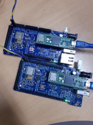

I am trying to send&receive CAN message using 2 teensy4.1.
I checked sending device message normally. But receiving device cannot receive can message.
Please tell me if you have any idea. Thank you.

Here is my pin connection image
If it's the board I think it is, there is a solder jumper on bottom labeled SJ7 that needs soldered on both boards.
For the receiving code, you EnableFIFOInterrupt() but don't attach a function or service the interrupt. Try just commenting out that line.
