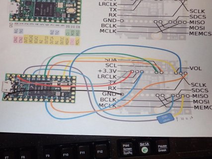

I am using Windows 8.1, a Teensy 4.0 and a Teensy Audio Shield.
I am running a modified SamplePlayer code which worked well with 8 separate sounds (notes) connected to three mixers (code below).
I am trying to build an electric steel drum and have a way to go since I want to have 29 separate sounds (notes).
I added two additional sounds to mixer 3 (bringing the total number of sounds (notes) to 10) and the program would not compile.
I got three errors, one says "...data' will not fit in region `DTCM'" and two say "...bss' is not within region `DTCM'".
I'm not sure what these mean, am I out of memory?
