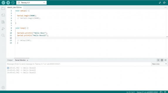

For Teensy, like ESP32, "Serial" is USB serial. If you are using pins 7 and 8 on Teensy 4.1, you should use Serial2..
I modified the code like this gave a try,
For teensy:
  // Serial2.begin(9600);
  Serial2.println("Hello Boss");
  Serial.println("Hello Boss22");
  //delay(150);
For Esp 32
// #define RXp2 16
// #define TXp2 17
  Serial.begin(9600, SERIAL_8N1, RX, TX);
    Serial.println("Message Received: ");
    Serial.println(Serial2.readString());
the connections are same.
Teensy is printing few statements and then it's not printing anything after that. I'm seeing nothing at esp32 side. adding the snippets for output on both modules.

Teensy will not transmit on pin 8 with Serial2.begin() commented. You need this for anything to work on Serial2.
Looks like the ESP side might also be missing a begin()...
In order to transfer the tx and rx from esp32 to teensy I think need to use the serial2.begin(); right? With Serial2.begin I'll should expect the tx and rx should be happening from teensy pins from 7 & 8 right?!
That is correct. Serial2 should use pin 7 RX Pin 8 TX by default

But the code above has: // Serial2.begin(9600);
Where the Serial2.begin is commented out...
Your programs have code to send data (text) out over the serial ports but nothing on either MCU to receive (read) the incoming serial data.

I enabled it and it was communicating. Thanks :)
