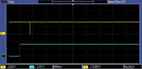

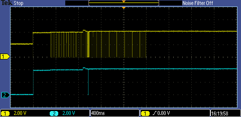

Finally got around hooking up my Teensy 3.0 to the scope and checking how the CS pins behave. So when I execute the following sketch, which reads a file from the SD card and uploads it to a webserver, ..
#include <Ethernet.h>
File fh;
EthernetClient dclient;
byte mac[] = { 0x90, 0xA2, 0xDA, 0x00, 0x58, 0x67 };
IPAddress ip( 192, 168, 1, 123 );
IPAddress gateway( 192, 168, 1, 1 );
IPAddress subnet( 255, 255, 255, 0 );
IPAddress server( xxx,xxx,xxx,xxx );
void setup(){
  pinMode(10,OUTPUT);
  digitalWrite(10,HIGH);
  if(SD.begin(9) == 0) //change to 4 when using Arduino
    Serial.println(F("SD init fail"));
  Ethernet.begin(mac, ip, gateway, gateway, subnet);
  delay(2000);
  Serial.println(F("Ready."));
void loop(){
  char fileName[14] = "test.txt";
  if (dclient.connect(server, 80)) {
    dclient.print(F("PUT /app/arduino/put.php HTTP/1.1\nHost: ")); //Host is mandatory in HTTP 1.1 and resolves issues when uploading to a server with more than one hostnames
    dclient.print(serverName);
    dclient.print(F("\nContent-Length: 5794 \nConnection: close\n\n")); //Content-Length is mandatory in HTTP 1.1 and must be at least the size of the uploaded data
    fh = SD.open(fileName,FILE_READ);
    byte clientBuf[64];
    int clientCount = 0;
    Serial.println(F("Writing"));
    while(fh.available())
      clientBuf[clientCount] = fh.read();
      clientCount++;
      if(clientCount > 63)
        dclient.write(clientBuf,64);
        clientCount = 0;
    if(clientCount > 0) dclient.write(clientBuf,clientCount);
    dclient.stop();
    fh.close();
  for(;;)
..on a Arduino Uno with an Ethernet shield, I get the following:
Yellow: Wiznet CS
Blue: SD card CS
But the same sketch running on the Teensy gives me:
On the same timebase for comparison, but even when viewed on a smaller timebase, it doesn't seem the SD card CS toggles on/off. Also, the Teensy doesn't even execute the sketch, it just gets stuck at the setup() loop.
Looks like the SPI library used by Teensyduino doesn't handle multiple slaves really well?

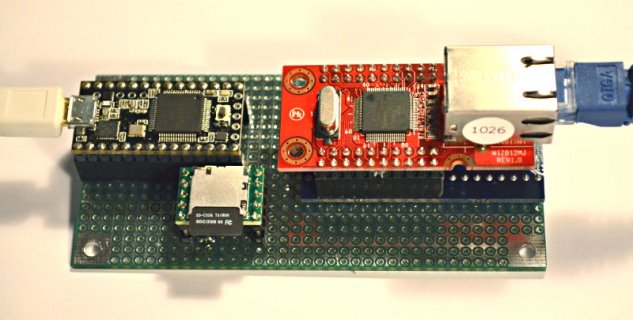

I built a board to test and I can confirm I have reproduced the bug here.
I probably will not be able to really investigate and fix this until next week (after Maker Faire). But I wanted to at least let you know I will work on this soon, especially now that I have this board sitting on my desk!
Here's the code I'm using.... (does not depend on specific network settings or a private server)

I believe I've found a workaround for this bug. Please give this file a try. It goes into libraries/SD/utility.
Please let me know is this solves the problem you're seeing?
