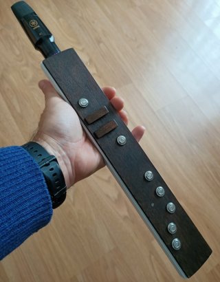

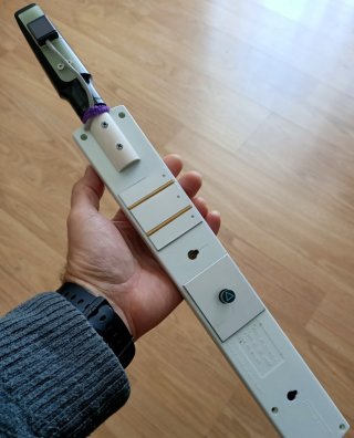

I've been looking at electric wind instruments, both professional and also do-it-yourself projects. The mouthpiece seems to be the most tricky part to get done right.
I have seen a few approaches for implementing breath sensors and bite sensors, and I'm not sure which one would be the most accurate / easy to implement using available parts, and also which one would work the best with Teensy to provide reasonable latency.

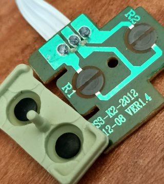

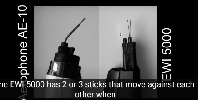

I have read an AKAI EWI tear-down article. They seem to be using some kind of capacitive sensing with two metallic plates getting pressed together when biting. I have looked at a similar DIY sensor article for Arduino, and it seems to be tricky to implement right - it needs very accurate resistor value tweaking and also depends on input pin specifics with internal pull resistors and maximal current. There might be a risk damaging my Teensy while experimenting with such a capacitor.
Also, I don't want to have a strong bite but more like lower lip pressure, like what I'm used to when playing my Clarineo.

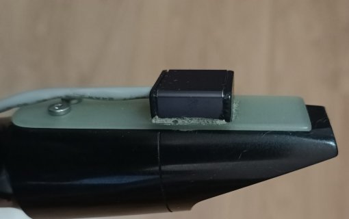

I have seen an article where a person uses a reflective sensor (QRD1114) for the bite mechanism. I don't have QRD1114 available, but I have CNY70 - should work the same, I guess.
But I'm not sure how to implement it mechanically - unfortunately, there are no detailed examples. So, my idea is to buy some cheap sax mouthpieces from China and a few plastic reeds to experiment with.
Then I cut the part under the reed to make it more round at the front, so that the reed has wider amplitude to move when I press it with my lower lip. Then it all boils down to - how to translate the small vertical movement of the reed to something that the optical sensor can understand with enough accuracy?
Also, I'll have to seal the sensor part to protect it from moisture (the open tube will drain it all out at the end of the instrument, the same way as Akai / Roland does).
