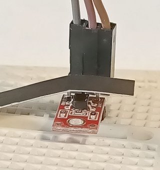

As a note on the optical method, I just found the service manual for the AE-10 online, it appears the cantilever bar is equipped with a tab that simply just sits on top of a reflective sensor (type KTIR0711S) which is much like this:
https://coolcomponents.co.uk/products/qtr-1a-reflectance-sensor
So, nowhere near as complex as I thought, and one point scored for an optical assembly in case the Hall Sensor does not work out. This system may not even need an amplifier as output swing is effectively a range between 0V to VIN (5V)
Took a while to arrive due to the delayed shipping these days, but I have tested the QTR-1A sensor.
It works at either 3.3 or 5 volts and has no trouble providing full scale output with 2-3 mm movement depending on the height of the reed above the sensor and reflectivity of the reed surface. I am surprised at the sensitivity and no signal conditioning or amplifier would be needed.
This will lend itself well to being inlayed into the mouthpiece beneath the reed and detect lip pressure movement.

I have made an optical joystick with these reflectance sensors to use in my new EVI project.
I replaced the potentiometers in a playstation remote joystick with small vanes that move toward / away from the sensor and this has proven to be much better than using pots.
Likewise, for the lip pressure sensor, testing shows this to be a viable, simple option. It will just reflect off the inside of the reed and
return ample signal requiring minimal processing.
