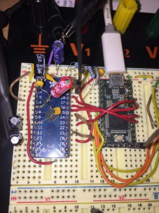

Hey guys, I am having the same issue here with SGTL5000, i ve tryed all sorts of ways from different topics, long wire, resistor, etc. I don't have the 600ferite as shown in the audio adapter but i've tryed one smaller and no difference at all. Also i made the connection as close as i can on the pins as you can see above. the VDDD is from tennsy dac set to 1.8 V, I tryed also with a external regulator but is the same.
Here are the connections
here is the code:

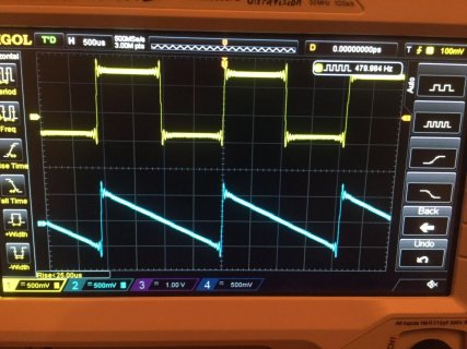

The two outputs on the dac showing the ringing
The problems are appearing only for waveforms with straight falls, for sine and triangle seems ok.
So If anyone of you can give me any explanation and a solution i would really appreciate it.

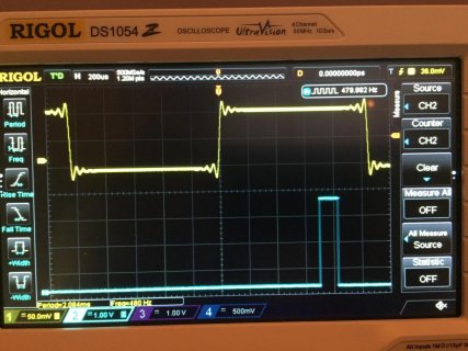

Try running this and measure the digital signal on pin 3 for comparison.
  analogWriteFrequency(3, 480);
  analogWrite(3, 128);
If you see similar or even worse ringing, the problem is very likely how you're connecting the oscilloscope probe. Long wire between the probe tip or probe ground and the Teensy pin & ground can cause any higher bandwidth scope to show this sort of ringing. It's a well known problem with high bandwidth measurements.
This is not unique to the SGTL5000. It is the result of band limiting a function that has no frequency limit. I have seen this on other sigma-delta DAC's. When you band limit, say, a square wave, the ringing represents the negative of the parts of the waveform that were removed.
There is lore that linear-phase filtering (FIR filters) stop ringing, but not so. Never-the-less, if you compare with a single in-out path filter (called a minimum-phase filter) it is quite a bit worse than the linear phase FIR filters such as are used here.

When I was young and digital audio made its way into consumer electronics (we are talking about the 1980ies), it was considered good practice to add an analog 18dB/oct or even more Bessel low pass (be it an active Sallen-Key or a passive LC) as a reconstruction filter behind each DAC to get a clean signal without artifacts...
And by the way, thanks to M Fourier, every signal with sharp transitions (harmonics beyond the filter corner frequency) will look like ringing when low pass filtered because the higher harmonics which would compensate this are eliminated. Thus, everything looks ok for me. cf. https://archive.cnx.org/contents/72f90f3a-f72c-4459-b439-1d27bf9d14d2@1/fourier-series-square-wave
Most everything you see is within the Nyquist frequency. The square wave has frequency components at all odd multiples of the base frequency. They decline in amplitude as the number goes up, of course. The LP filter in the DAC limits this to a finite number of components, and the overshoot and ringing is the result.
Hey Paul I did it, i don't think it's a probe problem, i did check with a analog one and is the same.
Here are the two signal
This picture shows clearly that there is exactly NO problem. This is not ringing what you see, but missing higher harmonics due to low pass (nyquist) filtering. Everything is fine.
If you add a FIR with same coefficients and depth to the digital output that you are probing, you will see the same result.
I didn't fully understand it and how to apply it, but anyway I did it from audiotool for 480 hz, and yes it's going to filter the harmonics. The problem is if i increase the frequency above 5000hz for ex, the waves are unintelligible..
