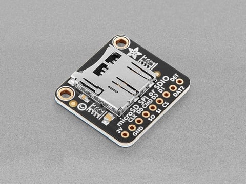

Not sure if anyone will be interested or not. But with the talk of maybe using SDIO to support some different WIFI controllers,
wondering how hard it would be to support SDFat on SDIO2, and with this could one use both of them on the same T4.1
Or custom boards.
Sorry, in advance - probably long and convoluted and confusing.
On T4.1 I am using:
CLK = 23, CMD = 22, Data: 40, 41, 17, 16
So, I am starting to experiment...

Code is still erroring out with Test program. Just using ListFiles with the change
  if (!SD.sdfs.begin(SdioConfig(FIFO_SDIO | USE_SDIO2))) {
  //if (!SD.sdfs.begin(SdioConfig(FIFO_SDIO))) {
  //if (!SD.begin(chipSelect)) {
    Serial.println("initialization failed! ");
    return;
  Serial.println("initialization done.");
Still getting errors, but some output as partial output:
Initializing SD card...SdioCard::begin: 1
351 IRQSTAT 2
911 IRQSTAT 2
351 IRQSTAT 2

@KurtE Just a note - I used that base PCB for SPI SerialFlash testing - that you helped with the PTR rewrite for SPI2.
With just SPI to that Flash the runs from the first headers to the fourth and fifth header rows was too long for reliable CHIP ID and usage.
Might assure better signal integrity to move the T_4.1 over two header sets toward the SDIO/LA pins? That will drop ~1.5" of PCB traces.
Thanks all,
I moved the T4.1 to the nearest slot on the board and I think it helped, thanks.

for the fun of it, I thought I would try MTP with the two SDIO cards on it:
C++:
#include <MTP_Teensy.h>
#define CS_SD BUILTIN_SDCARD  // Works on T_3.6 and T_4.1
//#define CS_SD 10  // Works on SPI with this CS pin
SDClass sd_io2;
  MTP.begin();
  // Add SD Card
  SD.begin(CS_SD);
  MTP.addFilesystem(SD, "SD Card");
  sd_io2.sdfs.begin(SdioConfig(FIFO_SDIO | USE_SDIO2));
  MTP.addFilesystem(sd_io2, "2nd SDIO card");
  MTP.loop();  //This is mandatory to be placed in the loop code.
Appears to be working at least some. I have not tried modifying files and the like yet

It is setup to use the Adafruit breakout board:
It is easier than soldering the SD connector and may be useful for the WiFi experiments.
