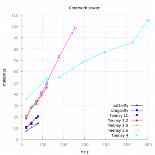

The 4 has a higher current draw which is important for battery operation - its way overpowered too I think

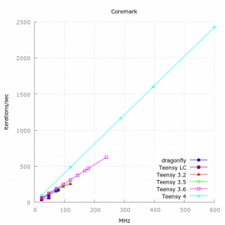

The 1062 in the T_4.0 and 4.1 can be clocked lower to use ~10-15% more power than a T_3.2, but offers 2X better performance - thanks to cache and other MCU features. Also the added RAM and onboard flash size.
Looking here gives graphs of relative coremark perf and current used across the PJRC ARM MCU's: github.com/manitou48/teensy4
near 200 Mhz seems like a sweet spot could be arranged in setup(), or the 396 MHz build option is ~5X faster at ~2X the current of a T_3.2 - and 528 MHz is much faster without the extreme current used at 600 MHz where the MCU voltage is pushed up:
