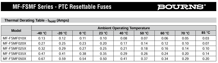

For reference, this is the actual PTC used on the board per a post by Paul: https://www.digikey.com/en/products/detail/bourns-inc/MF-FSMF050X-2/2039256
Possible degradation aside, operating the PTC at a high temperature will lower the trip current since the PTC is basically just a thermistor that self-heats and then knees over. Here is the thermal derating table from the spec sheet. Rated at 500mA @ 23C, but derates quite a bit as ambient temps go up from there.
In your application where the power draws are well understood and fixed and a fairly hot environment, I think bypassing the PTC as you are doing is probably the best course of action and I can't imagine any long-term consequences. You could always put a mechanical fuse in the 5V line if you wanted to implement some type of current protection on that circuit.

But reading the spec sheet linked above, I just noticed something that the other spec sheet I had studied did not include:
Trip Cycle Life - Vmax, Imax, 100 cycles
Vmax is 6V, and Imax is 40A for the part used on the Teensy 4.1.
This gives a general idea that the part is not expected to trip a lot and still meet its specifications. But the question remains, how fast does it decline in practice? Our system was resetting in a boot loop at around 10 seconds per cycle. 16 minutes of being stuck in that boot loop would exceed the 100-cycle limit of the PTC. So if it's resetting and not being noticed, it could cycle 1000s of times.
