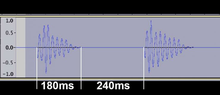

Hi, I'm using the audio peek function to do beat detection and i am getting a false read.
Basically I want to blink an LED every other beat so I detect the beats and then use case: to either turn on the LED or ignore the beat.
The sounds I am using as my test has a beat of around 180ms then a gap of 240ms before the next beat (see image attached).
So, in theory I should be able to detect a peek then wait for 200ms before waiting for the next peek.
When I do have a 200ms delay and process this sound, the sketch detects 4 beats instead of 2.
With a delay of 400ms the sketches detects 3 beats.
If I up the delay to 500ms then it only detects the 2 beats.

You don't show printed output of a run. As it is, I don't think it would help see the problem.
Add a print of rightPeak whenever you detect over thresholdlevel.
Your delay() may be getting in your way.
I don't know the operation of peak_R funcs() - but if you read it at 15 as a peak, I assume it would then reset at 16 and up, while you are in the delay. So you might see improvement if you do an: if (peak_R.available()) peak_R.read(); right after the delay()
A quick and dirty fix could be instead of an 'arbitrary delay' replace delay() with:
   fps = 0;  // use as a timed or forced exit to the loop, then reset
   while ( (100>fps) && !(peak_R.available()) ) {
      if ( (peak_R.read() * 30.0) > thresholdlevel )
        fps=1000;
   fps = 0;
If that (or something sensible) fixes it - then rewrite your code so the outer test does something similar except don't enter your current code until the current peak drops.

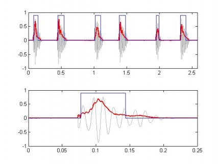

slightly OT
being a fan of detection algorithms I played with the pulses (using Matlab) and come up with the following detection algorithm
fname= '\users\walter\Downloads\6 Beats.wav';
info=audioinfo(fname);
[xx,fs]=audioread(fname);
tt=(0:size(xx,1)-1)'/fs;
% modified Taeger Kaiser (adapted to filter multiples of 60 Hz)
f0 = 60; %Hz
nn=size(xx,1);
ii=1:size(xx,1);
di = round((fs/4)/f0);
ia = max(1,ii-di);
ib = min(nn,ii+di);
yy= xx(:,1).^2 - xx(ia,1).*xx(ib,1);
% threshold detector
th = 0.1;
zz= yy>th;
% bridge short holes in pulse detection
% find detections
dz=diff(zz);
iu=find(dz>0); %start detection
id=find(dz<0); %end detection

is = find((id-iu)<2*di);
for ii=1:length(is)
    jj=is(ii);
    kk=iu(jj):id(jj);
    zz(kk)=0;
end
iu(is)=[];
id(is)=[];
figure(1),
subplot(211)
hp=plot(tt,xx(:,1),tt,yy,'r',tt,0.9*zz,'b');
set(hp(1),'color',0.7*[1,1,1])
set(hp(2),'linewidth',2)
xlim(tt([1,end]))
subplot(212)
xlim([0 0.25])
generating the following output

figure(1),
subplot(211)
xlim(tt([1,end]))
subplot(212)
xlim([0 0.25])
