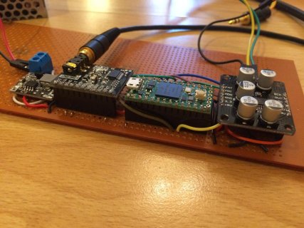

* uses Teensy 4.0 and external ADC / DAC connected on perf board with ground plane
* but should run also with the PJRC Teensy Audio board version D (compatible with Teensy 4.0)
* this sketch does only run with the Teensy 4.0, do not use with Teensy 3.x
* My sincere thanks go to Brian Millier, who accurately measured latency in a first version and also found the bug in the system!
* PCM5102A DAC module
VCC = Vin
3.3v = NC
GND = GND
FLT = GND
SCL = 23 / MCLK via series 100 Ohm
BCK = BCLK (21)
DIN = TX (7)
LCK = LRCLK (20)
FMT = GND
XMT = 3.3V (HIGH)
PCM1808 ADC module:
FMT = GND
MD1 = GND
MD0 = GND
GND = GND
3.3V = 3.3V --> ADC needs both: 5V AND 3V3
5V = VIN
BCK = BCLK (21) via series 100 Ohm
OUT = RX (8)
LRC = LRCLK (20) via series 100 Ohm
SCK = MCLK (23) via series 100 Ohm
GND = GND
3.3V = 3.3V

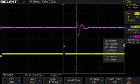

// uncomment for Serial print out of latency
#define LATENCY_TEST

#if defined(LATENCY_TEST)
if(all_samples_counter > SAMPLE_RATE && !no_more_latency_test)
// latency test
fftin[42] = 1.0; fftin[44] = -1.0;
fftin[43] = 1.0; fftin[45] = -1.0;
no_more_latency_test = 1;
if(!no_more_latency_test) all_samples_counter += partitionsize;
