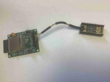

It would seem like you must have a bad Teensy Audio shield. It definitely should work with the audio shield mounted directly onto the T3.6 via short headers. I assume you are testing it with something simple like the audio pass-through demo, thus eliminating any code errors. (although you can get things working with your alternate ADC/DAC, so the code must be OK)
My old audio shield works great on the T4- you can see the length of my wiring in post #14. I only use a 100 ohm resistor on MCLK.
For your conv. filter testing, I just used the SD card socket on the audio shield. But,for my T4 Soundfont Synth, I used only a PT8211 DAC. For the SD card socket, I hand-wired one up from the footprint on the T4 PCB bottom. I had to use wire-wrap wire for this, but the wiring is about 11 cm long, and that works fine.
