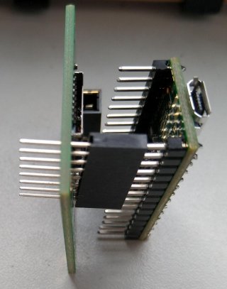

the T4 audio shield just had arrived.
Now the hurdle is how to connect the pieces together.
I had soldered common header pins to the Teensy T4 board (sticking downwards) prior to having the audio shield.
Apparently, it would have been better to use A 14 pin socket.
It's hard to reverse if it were done wrongly.
Like this?
Frank and Tim already said everything necessary to eventually come to a success, but I think this photograph can back it up [but you only use ONE audio board ;-)]:
https://www.pjrc.com/store/teensy3_audio_quadch.jpg
And yes, I would also think that it would be great to have the audio board silk screen on both sides and a large text indication of the Teensy version it can be used with.
"The headphone socket must be on the same side as the teensy usb connection."
That's weird since totally unexpected in view of boards being sold with those (short) header pins oriented downwards (for instance https://opencircuit.shop/Product/Teensy-4-met-headers)
The mounting picture is hard to understand (shown for T3 (!) https://www.pjrc.com/store/teensy3_audio.html).
The USB socket can only be guessed. Since USB socket is symmetrically on the T4 board it is unclear if the Reset button points to the breadboard or towards the audio shield.
Is the reset button located between the T4 and the shield?
Or shall the Reset button point to the breadboard?
