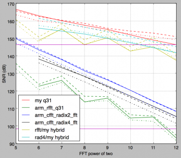

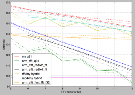

So here's a quick summary of the performance of doing FFT->IFFT for the arm_rfft_q31, arm_cfft_radix2_q31,
arm_cfft_radix4_q31, together with my FFT coded to do divide-by-N only in the forward direction, and some
hybrid schemes using my invertse FFT after one of the arm forward FFTs:
The solid lines represent a random signal, the dashed lines a single sinusoid, and the dash-dot lines are a two-tone
sinusoidal signal. The variation between them is interesting, I've not thought about why, but it gives some idea of
the variation in the data.
The two magenta lines represent the SNR of 24 and 16 bits. The 6dB drop as the FFT size doubles clearly shows
for the arm routines, together with a smaller rate of drop for my routine and the hybrid cases. Also of note is the
oscillating behaviour of the SNR for the rfft_q31 version - the real fft as I understand it uses the standard trick
of packing 2N samples into N complex numbers allowing the actual FFT to be of half the size it would otherwise be,
I suspect its choosing the radix4 fft when it can (faster), the radix2 otherwise, leading to the oscillating SNR performance.
A conclusion is that despite the 32 bit fixed point representation the q31 CMSIS routines aren't giving much/any better
precision than the single float routines for this style of FFT -> IFFT processing, and that this is fixable by using an
implementation of inverse FFT which doesn't throw away bits.

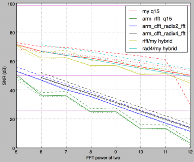

Another conclusion is that the situation for the q15 inverse FFT is _much_ worse, and its basically unfit for most use-cases,
as for instance a 1024 point q15 inverse FFT is effectively somewhat less than 6 bit precision!
