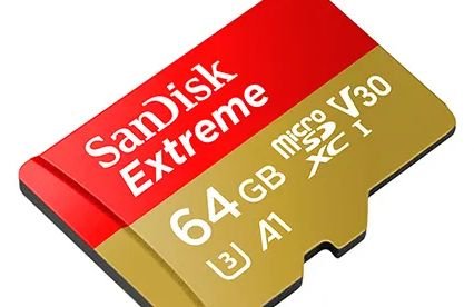

Perhaps. Let's see what a one hour run looks like with a proper card.
My own bench.ino tests with Sandisk XC is ~23MB/sec over SDIO, 2x faster than HC:
FreeStack: 449400​
Type is exFAT
Card size: 63.86 GB (GB = 1E9 bytes)
Manufacturer ID: 0X3
OEM ID: SD
Product: SP64G
Version: 8.0
Serial number: 0X28D120F8
Manufacturing date: 1/2012
FILE_SIZE_MB = 5

I learned only high speed mode is supported, which runs at 50MHz - with 4 bits of data per clock that's a maximum transfer rate of 25MB/s which is pretty close
Yes, I was seeing similar numbers on my cards- even Class I. The problem is that it’s an average. The card datasheets don’t tell you the maximum latency. That is they may plow along at 25mb/s but then do housekeeping for 50msec. That means you need to buffer 1.24Mbytes of data if you are streaming and can’t just hold off until it’s able to store data again.
I have the additional problem of my data interrupt which takes about 45nsecs. Which seems minuscule but it occurs every 222nsecs. That’s a significant hit on the time allowed for the sdfat routines to run.
Frankly, I am super impressed by the performance of the library. I basically took the bench.ino and reshaped it for my needs. Every problem I’ve had so far has been my fault.
