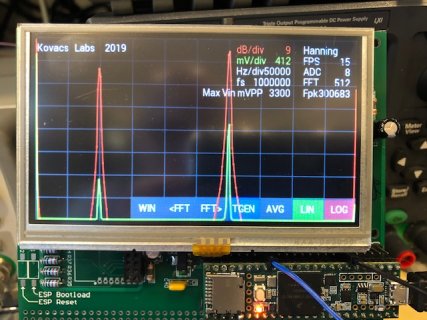

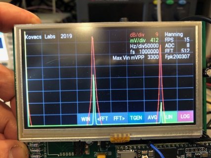

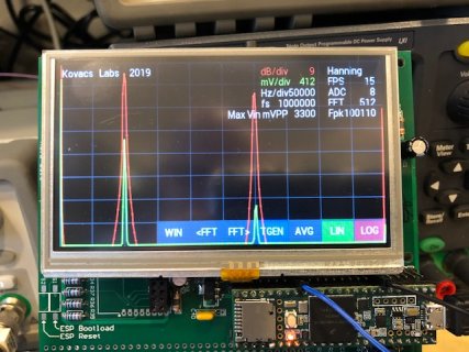

Anyway, the first three photos show an input signal at 100 kHz, 300 kHz and 490 kHz (here the Nyquist frequency is 500 kHz). Again, the input is a squarewave, so the Fourier series that "it's made of" has harmonics at 3X, 5X, and all odd numbers upward. The 300 kHz harmonic of the 100 kHz input signal is clearly visible at 1/3 the amplitude of the fundamental (expected) at 300 kHz (expected). A close look will show the 500 kHz harmonic at the right of the screen at 1/5 the amplitude. Great!
You might note that the Fpk value on the display is the computed peak frequency, which matches what is put in. Also good proof that it's working ok.
There is no anti-aliasing filter here, so the higher harmonics "fold" around zero frequency. So the 300 kHz harmonic at 900 kHz should show up at the sample rate minus the harmonic frequency or 100 kHz. It does. Cool.
The last image shows 490 kHz being input, and a complex batch of small peaks due to folding, jitter, etc. In normal use, there would be no frequencies put into the FFT above the Nyquist rate to prevent this, but here (again), I am using a digital input, which is a squarewave, and it is coming from an external signal generator, so it is wandering relative to my sampling interrupt routine.
So 1 Ms/s is possible. Now how to get the data in?

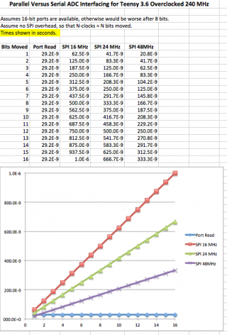

So, how fast can it go in port versus serial mode? First, I measured how fast the port could be read, regardless of pin scrambling, with this code (noting that it did not change the results if the variables were int or long):

Further, this shows that even at 48 MHz SPI speed, the maximum sample rate for a 16-bit ADC (readily available) is 1 Ms/s. So there, folks, is a basic case for why parallel still has a role in the world. This is just the basic case, and maybe bit-bang SPI could somewho go fast? Maybe some DMA tricks? This is just to make a simple point, so no need to invoke complexity.

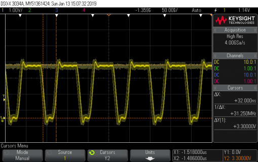

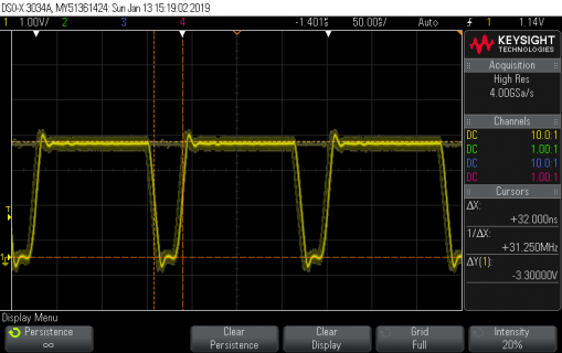

So, what do I see on the oscilloscope? A nice-looking waveform with a bit of as-yet unexplained jitter as seen in the background - I have infinite persistence on in the scope).
Image:
[Simple_PortIO_Jitter_NoInterrupts]

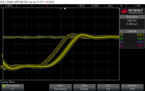

So what is the timing? The reported elapsed time flips each cycle between 1503 and 503 us, but there is a good reason (please see below). The sample rate (repetition rate, since we are not yet sampling anything) is 11.43 MHz (measured on oscilloscope), which corresponds to an 87.5 us period. Duh! Interrupts are needed for the elapsed time calculation! Turn them back on, and you get jitter, but a decent time estimate of 83.39 ns, or 12 MHz. Great! Here's the jitter, FYI:
Image:
[Simple_PortIO_Jitter_Interrupts_On]

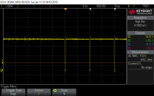

Just for grins, note that the jitter is about 4 ns and there is also some "missing pulse" jitter, which is the background straight line at 3.3V.
Image:
[Simple_PortIO_Jitter]

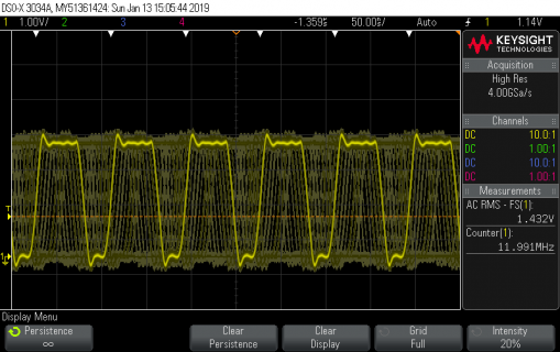

We get a nice waveform on the scope at a 5.996 MHz repetition rate (not bad), with our 32 ns start pulse intact. The timing reported serially, again with interrupts disabled for this purpose, is 16.66.777 ns or 6 Ms/s (close enough!).
Image:
[Sope_Kludgy_PortIO_Full_Tilt]

Image:
[von_Neumann_Bottleneck]
Image:
Image:
Image:
Image:
