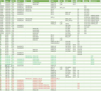

I have an application capturing both analog and digital data up to a rate of 128ksps.
At the moment the ISR is taking too much time and making the 128ksps rate unviable for streaming purposes.
I have determined that the digital input reading and byte assembly is by far the slowest part of the routine (below).
Note that these inputs are not readable as a single byte (unfortunately).
The digitial input read and byte value assignment is taking an average of 206ns out of a total of 375ns so pretty horrible.
Obviously my code is terribly inefficient but I'm not sure which approach would be significantly faster?
I have not implemented ISRs to service the digital inputs individually as I need to keep the ADC ISR very high priority and low jitter.
