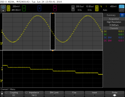

Since I'm also curious about this, I tried a quick test with 44.1 kHz sample rate, using this code:
AudioSynthWaveform  osc;
AudioOutputAnalog   audioOutput;
AudioConnection c1(osc, audioOutput);
  AudioMemory(6);
  osc.begin(0.95, 1000, TONE_TYPE_SINE);
  audioOutput.analogReference(INTERNAL);
Here's the DAC output with only a 10X (approx 9pF capacitance) scope probe connected to the PCB pin.
(click for full size)
This is with the scope's horizontal zoom turned on, so you're seeing the same waveform twice, where the bottom is zoomed in to 10us per division.

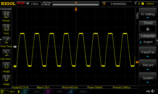

K66 DAC settle time (data sheet says 15 us)
Just for the record, with only the scope probe connected to A21 on T3.6, running a simple square wave
  while (1) {
    analogWrite(A21, 0);
    delayMicroseconds(1);
    analogWrite(A21, 255);
I get the following
Rise time of 540 ns. (By comparison, digitalWriteFast() toggle of digital pin has < 40 ns rise time)
