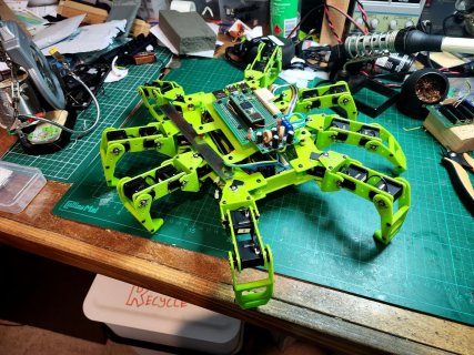

This is less asking for guidance and more sharing what I have figured out. Getting the Feetech servos running on my robot has been a bit challenging as there's not a lot of up to date information or source code available, added to my own blunders - this was a bit annoying!
I build robotic spiders, I have 4 models:
- Steve: arduino mega + 32 channel serial PWM servo controller + 24 hobby servos
- Yorick: Jetson nano + Pi + teensy 4.1 + rs485 MAX + 24 x rs485 dynamixels MX series servos
- Bobbie: Jetson nano + teensy 4.1 + ttl chip (forgot this one) + 24 x TTL dynamixel X series servos
- Stef: Pi + teensy 4.1 + Feetech TTL linker + 24 TTL micro Feetech brushless servos
The cost of the dynamixel servos is what led me to the Feetech servos, 2 of the MX64 servos cost more than 30 of the Feetech servos.

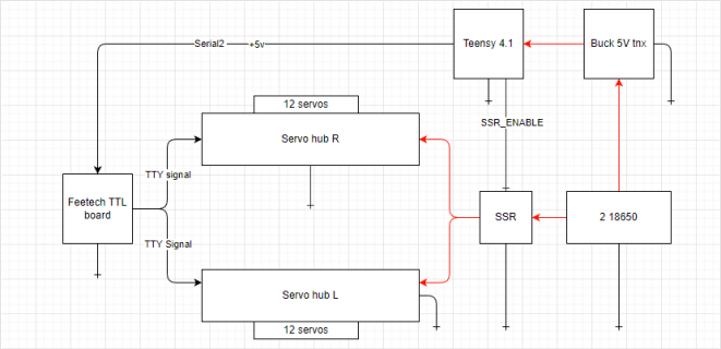

Hardware Layout
Very basic layout diagram - the key point to mention here is that i have powered the TTL Linker board from the 5v supply and not connected the battery to the TTL board, it works well this way and doesn't try and power 24 motors via the Linker board.

It's not walking yet but it's looking good!
Happy to answer questions

Hardware Layout
