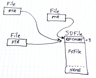

I'm been quiet for the last few days while working on a long-planned change to bring the File class into Teensy's core library, and to remove the Arduino SD library and migrate all SD card use on Teensy to SdFat.

3: Having the File class in the core library will allow USBHost_t36 to give File class objects for USB mass storage devices. So any library or code that uses File will be able to access either type of media, and other types of media or virtual files in the future.
