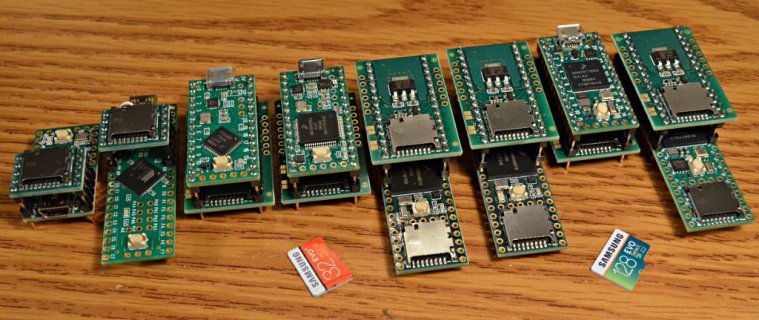

Doing more testing I have discovered that using cardInfo.ino without my mods to SD.h is hit and miss when trying to use external SPI. It seems like it is a timing problem. Performing multiple programmings will work sometimes but not all the time. Performing multiple programming button presses will work sometimes. Using TyCommander reset function will work sometimes as well. The kicker is that it completely depends on the SD card that I am using. Using some Samsung cards work and some don't. Some PNY SD cards work and some don't. Using sdInfo.ino seems to work with everything consistently.
Just curious as to why
Edit: The Modifications I made do not change anything.
