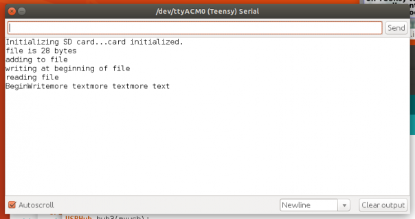

This does not work:
Normally I ask for a complete program to reproduce the problem. But this seemed so trivial that I just wrote a little program to test.
const int chipSelect = 10;
  while (!Serial) ; // wait for serial port to connect.
  if (!SD.begin(chipSelect)) {
    Serial.println("Card failed, or not present");
    while (1) {
  Serial.println("card initialized.");
  const char *path = "myfile.txt";
  File f;
  f = SD.open(path, FILE_WRITE);
  int len = f.size();
  Serial.print("file is ");
  Serial.print(len);
  Serial.println(" bytes");
  if (len < 80) {
    Serial.println("adding to file");
    f.print("more text");
  f.close();
  Serial.println("writing at beginning of file");
  f = SD.open(path, FILE_WRITE_BEGIN);
  f.print("BeginWrite");
  f.close();
  Serial.println("reading file");
  f = SD.open(path, FILE_READ);
  if (f) {
    char buf[100];
    int len = f.read(buf, sizeof(buf) - 1);
    buf[len] = 0;
    Serial.println(buf);
After I run this 4 times, the file does have the "BeginWrite" as its first bytes and the effect of the file growing each time I run it can be seen.
Seems to work fine. I tested with 1.54-beta6.
If you still believe there is a bug here, please show a complete program which reproduces the problem.

Sorry not sure what the glitch is? Does not start writing at start? When you close file does not remove data after last write? Probably by design. If you want to truncate you probably have to explicitly call member methods to do so.

Yes, I didn't properly state the problem in the previous message.
However, the sketch don't compile when 'FILE_WRITE_BEGIN' is referenced.

the symbol is defined in cores/teensy(3/4)/FS.h
can you check its existence, or if you have a second FS.h on your system?
maybe in "SD-Juse_Use_SfFat"?
From your error log on msg #63:
/home/linuxgoran/Downloads/arduino-1.8.13-linux64/arduino-1.8.13/hardware/teensy/../tools/arm/bin/arm-none-eabi-g++ -c
 -O1 -g -Wall -ffunction-sections -fdata-sections -nostdlib -MMD -std=gnu++14 -fno-exceptions -fpermissive -fno-rtti
-fno-threadsafe-statics -felide-constructors -Wno-error=narrowing -mthumb -mcpu=cortex-m7 -mfloat-abi=hard -mfpu=fpv5-d16
 -D__IMXRT1062__ [B][COLOR="#B22222"]-DTEENSYDUINO=153[/COLOR][/B] -DARDUINO=10813 -DARDUINO_TEENSY41 -DF_CPU=450000000
 -DUSB_SERIAL -DLAYOUT_US_ENGLISH -I/tmp/arduino_build_638032/pch
-I/home/linuxgoran/Downloads/arduino-1.8.13-linux64/arduino-1.8.13/hardware/teensy/avr/cores/teensy4
-I/home/linuxgoran/Downloads/arduino-1.8.13-linux64/arduino-1.8.13/hardware/teensy/avr/libraries/SD
-I/home/linuxgoran/Downloads/arduino-1.8.13-linux64/arduino-1.8.13/hardware/teensy/avr/libraries/SPI
/tmp/arduino_build_638032/sketch/Datalogger.ino.cpp -o /tmp/arduino_build_638032/sketch/Datalogger.ino.cpp.o
Datalogger:40: error: 'FILE_WRITE_BEGIN' was not declared in this scope
           justTest =  FILE_WRITE_BEGIN;   // Will not compile.
Looks like you have Teensyduino 1.53 installed.
For FILE_WRITE_BEGIN and all the other new SD / SdFat stuff, you need to install 1.54-beta6.
https://forum.pjrc.com/threads/66182-Teensyduino-1-54-Beta-6
