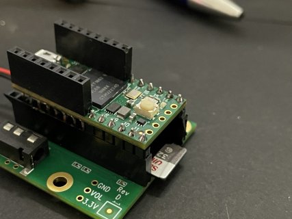

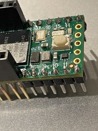

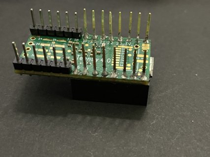

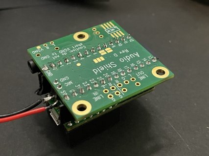

I have scoured the forum and seems soldering is often the issue, but I've resoldered several times with no luck. I've attached photos of my solder job in case they're not as viable as I think.

Two quick ideas...
1: Try running SD CardInfo example. If the card is detected but data format isn't usable, CardInfo will at least tell if the hardware was detected and which type it is and its capacity.
2: Remove the SD card and try running the LED blink example (File > Examples > 01.Basics > Blink). Look for the LED to blink (it's on pin 13, which is also 1 of the 4 signals to the SD card). Then try using a voltmeter to observe the voltage. Maybe edit the code for longer delays if your multimeter responds slowly. If you can see the voltage change, edit the blink program to pin 10, 11, 12 and repeat.

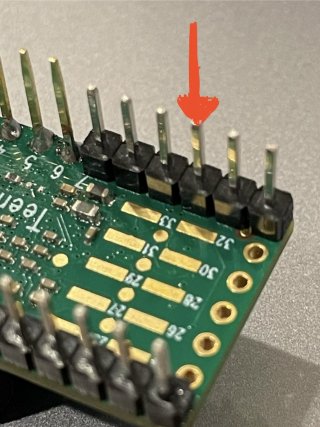

More focused photos of the 10 pin on both sides of the Teensy to show that I don't believe it's a sloppy solder causing the issue.

With power off and no audio shield connected, next I'd try measuring ohms between pin 10 and 3.3V. Bur first, touch the 2 leads together to check what your multimeter actually reads for zero.
If you get a reading close to zero ohms between pin 10 and 3.3V, while power is off and nothing else connected, that's a sign you probably have a metal short somewhere. Usually those metal short problems are fixable if you can find and remove the stray solder or metal object.
If you get a "strange" reading, that's probably a sign of damage within a chip. Probably best to just replace Teensy rather than pouring more time into a problem that probably isn't viable to repair.
Thanks y'all for your input! I washed the flux off (with a small paintbrush and 99% isopropyl) and no change.
When checking the resistance, pin 10 reads about 630 while all other pins read about 470. Sounds like damage to the chip. Thank you both for your troubleshooting support on this! I have a new Teensy in the mail now. :)
You should also check pin 10 on audio pcb with Ohm meter between pin 10 and 3.3V just in case audio pcb is source of the fault.
