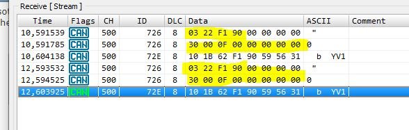

ID: 666 LEN: 121 FINAL ARRAY: 49 2 1 1 2 3 4 5 6 7 8 9 0 1 2 3 4 5 6 7 8 9 0 1 2 3 1 4 5 6 7 8 9 0 1 2 3 4 5 6 7 8 9 0 1 2 3 4 5 6 7 8 9 0 3 3 2 4 4 F F F F F F F F F F F F F F F F F F F F F F F F F F F F F F F F F F F F F F F F F F F F F F F F F F F F F F F F F F F F F 5
ID: 555 LEN: 121 FINAL ARRAY: 7 3 2 1 2 3 4 5 6 7 8 9 0 1 2 3 4 5 6 7 8 9 0 1 2 3 1 4 5 6 7 8 9 0 1 2 3 4 5 6 7 8 9 0 1 2 3 4 5 6 7 8 9 0 3 3 2 4 4 F F F F F F F F F F F F F F F F F F F F F F F F F F F F F F F F F F F F F F F F F F F F F F F F F F F F F F F F F F F F F 5
ID: 133 LEN: 16 FINAL ARRAY: 9 9 9 1 2 3 4 5 6 7 8 9 0 0 0 3

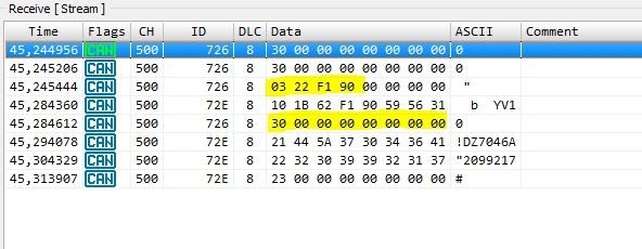

can0 7DF [8] 02 09 02 00 00 00 00 00
can0 7E8 [8] 10 14 49 02 01 33 46 41
can0 7E0 [8] 30 00 00 00 00 00 00 00
can0 7E8 [8] 21 44 50 34 46 4A 32 42
can0 7E8 [8] 22 4D 31 31 33 39 31 33

Add Tony's example to your global rx callback (canSniff)mm, what do u mean? Add this if to loop()?
I m try it, but looks no any 30 00 msg
