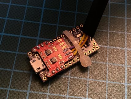

hy,

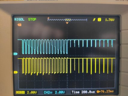

I'm trying to test out my Teensy canbus board with SN65HVD230 canbus transievers and a T4.1. I have 3 transievers, one for each output, but i can't seem to get the T4.1 sending messages. At first i tried just sending messages on one T4.1 and recieving it on the same one, but couldn't get it to work. So i made a schetch and placed it on 2 seperate T4.1's with one recieving and one sending. Still, i'm not able to get the T4.1 sending messages. i hooked up my osciloscope, and noticed the CTX pin is not sending anyting, even when changing canbus. However, the LED is flashing correctly, but i am never getting a "can2 recieved" message in my terminal.
Rayan, just an idea:

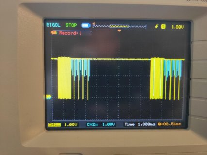

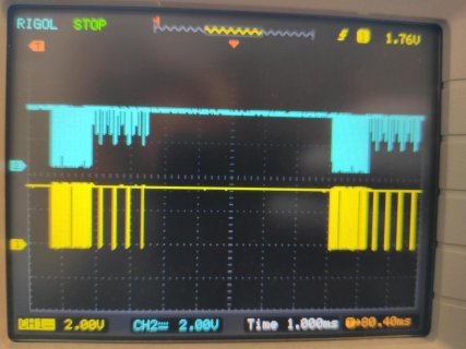

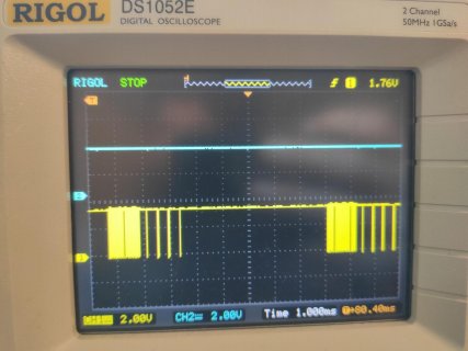

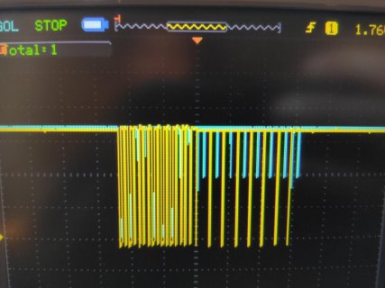

Can you record a single frame on your scope, with the probes on the receiving node's RX and TX signals?
Does RX look like a proper CAN frame?
Is TX quiet, except for a single ACK bit?
Can you post a picture of the recording?
Hi msadie,
here is the TX (blue) and RX(yellow) of the sender:
here is the TX (blue) and RX(yellow) of the reciever:
I tried switching the reciever and sender nodes arround, but it results in the same behaviour. It seems like the reciever is not sending an ACK bit, but the RX looks like the send TX. The delay between the TX_transmitter and RX_reciever signal is 40us, so i don't think that should be a problem

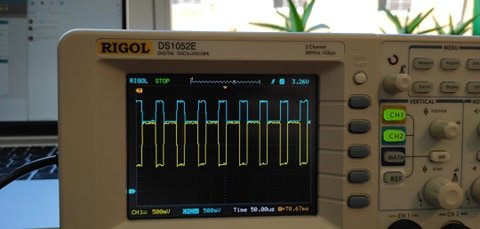

Good news, i found the fault in the design.
Even though i followed refference design of the SN65HVD230 transiever chip, the TX capacitor is not supposed to be there.
As such, here is the current, and working schematic.
Thnx a lot,
RR
I can't see a reference design - the datasheet does explain about noise-reducing components on the digital signals,
but you seem to have used 100nF for a noise-reducing capacitor value which is far too large. 33pF, 100pF, that
sort of value is appropriate. Only the decoupling capacitor(s) should be 100nF (C4 in your circuit). C5 and C6
are on a logic line, not a supply, so you don't decouple them.

Here's my setup. This is a custom PCB I made, which has dual TCAN330's. There are pins to pull SHDN/SILENT modes high or low (Teensy pins 2, 3).
The board has a jumper pad that should be cut to either control SHDN or S. I have not cut the trace, thinking I can just pull both low at the same time (maybe this is the mistake?).
I am using one of the examples sketches, just adding the pullup/down:
