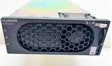

when the temperature of the external device rises, the power supply R4850 must reduce the output voltage,
the code works, but when switching the voltage there is a delay of 60-70 seconds, this is a lot!
how to remove this delay? I will be very grateful for your help!

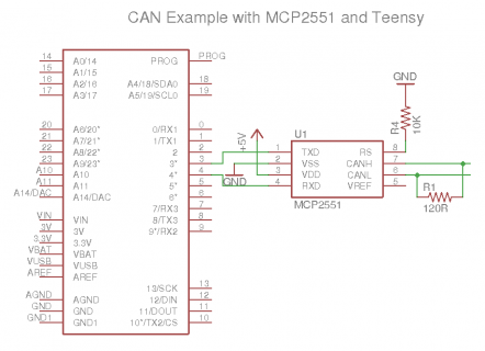

I use this wiring diagram ..
MCP2551 is a 5V transceiver, you need to make sure the communication is done at 3.3V or you risk damaging the pin on teensy. Or look for a 3.3V transceiver
2.0-2.5 volts, these levels correspond to Teensy,

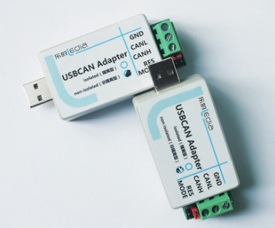

have you checked with a can bus analyzer to see if data is going out? or try another can-equipped bus just to see if you can read the bus (using FIFO example). If you can't read the bus don't expect transmissions to work, if you can read the bus, best to check if your frame layout is correct for the device your talking to

did you read last line of the xlsx? :)
The rectifier can operate in two states:
Off-line is when there is no CAN communication (i.e. standalone operation). This occurs on power-up or if CAN communication has timed-out (Orange LED slowly blinking).
On-line values are only valid when CAN communication is present (Orange LED not blinking). These values are volatile and reset to default on loss of CAN comms.
CAN communication time-out is approximately 60 seconds. i.e. if you stop sending valid CAN messages to the rectifier, the rectifier will switch to Off-line/Default values in approximately 60 seconds.
You basically need to keep transmitting whatever within 60 seconds for it to remain active, if you stop transmitting for 60 seconds thats it. so send every 30 seconds if you want
