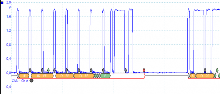

Physically the CAN was also checked by Picoscope -> transmitted signals arrive at CAN-H/CAN-L header

Interesting is that my CAN transmitter (restbus simulation from Windows PC) shows a Not Ackknowledge Error, which normally means that there is no receiver on the bus.
The serial output remains empty.
