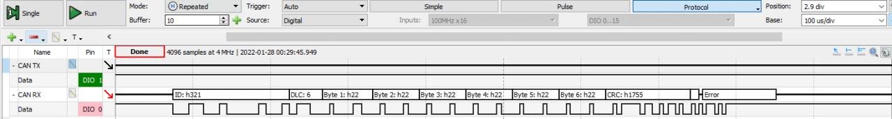

Advice on bad CANFD signal?
Running into a weird issue with the CAN3 CANFD transmission. I've got my script setup as below, most of it matches the documentation's examples, and I've got it set up to broadcast a message every 500 ms. The system works fine for CAN2.0, but when I try and do it using CANFD, the data seems to be getting garbled in output.

I'm snooping on the line using an Analog Discovery 2 and it looks like the signal is getting messed up, with only a couple of bytes of data being sent before it shows an error. I've attached a screenshot of the data stream below.
Any advice on what is going wrong would be appreciated, I'm at a loss right now.
I'm using a TJA1050 based CAN transceiver, have two Teensy 4.0s communicating back and forth, with a logic level shifter sitting in between to handle the 5 V -> 3.3 V drop between the transceivers and the Teensys.
You need to use CAN FD transceivers such as MCP2562FD or TJA1462.
