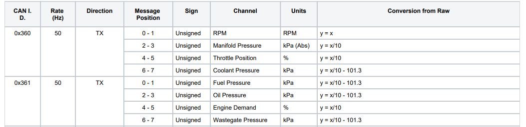

Hi All,
I have been doing searching and haven't managed to find it anywhere so thought I would ask here. I have a Teensy 4.1 that I am using as a body/chassis ECU that sends data to a Raspberry Pi for a digital dash in my car. I am switching from an OEM ECU using OBD to an aftermarket ECU. The new ECU uses Haltech CAN bus protocol. Does anyone know how I alter the code so that the Teensy will read the Haltech CAN bus messages? I have added the code from Arduino IDE below. Many Thanks in advance
 #ifndef CANBUS_H
#define CANBUS_H
#include <FlexCAN_T4.h>
#include "values.h"
extern FlexCAN_T4<CAN1, RX_SIZE_256, TX_SIZE_16> can1;
extern Values values;
void canSend(uint8_t activeByte){
  CAN_message_t msgTx;
  msgTx.len = 3; // number of bytes in request
  msgTx.id = 0x7E0; // Request Header
  //  msgTx.flags.extended = 0; // 11 bit header, not 29 bit
  //  msgTx.flags.remote = 0;
  msgTx.buf[0] = 0x02; // Number of bytes in request
  msgTx.buf[1] = 0x01; // Mode of request (0x01 = OBD2)
  msgTx.buf[2] = activeByte;

Some info on Haltech:
Key Information
The Haltech CAN bus operates at 1MBit and uses 11-bit IDs. IDs are expressed in Hexadecimal.
The first byte in a packet is considered byte 0, and the 8th byte is byte 7. The most significant bit in a byte is considered bit 7 and the least significant bit is
bit 0.
Data is encoded as big endian.
Hi All,
Key Information
bit 0.
The general idea is to replace your canRecieve function with code that just checks for IDs you want. If ID matches 0x361 (for example), grab the correct bytes and join them, then convert to physical units. Also, be sure to correct the baud rate in canInit.
Here's an example of how to get oilPressure:
void canReceive(const CAN_message_t &msg){
  // Handle 0x361 messages (~50Hz)
  if (msg.id == 0x361) {
	// Oil Pressure
	values.oilPressure = (float)(msg.buf[2]<<8 + msg.buf[3])/10.0f - 101.3f;
*Note: I haven't checked or tested this code in any way*
If the numbers you are receiving don't make sense, try switching the byte order.
