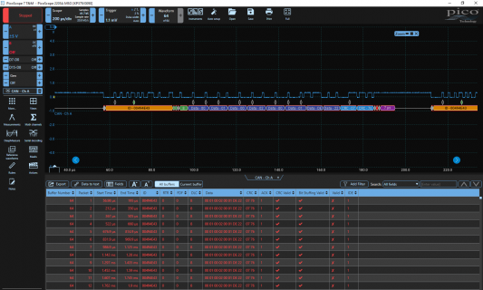

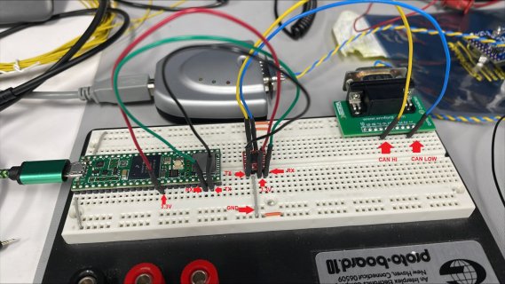

I'm currently troubleshooting an issue with my system not receiving CAN messages. I have tried to implement the FlexCAN_T4 examples, but I haven't had any success. I've checked my oscilloscope and it shows that the ACK bit is staying at (1) when it should have been changed to (0) by the library. All I need is to be able to receive messages, not need to transmit messages. Please refer to the attached pictures for more details.
In the scope image, the data was captured at PIN-30 (RX). CAN messages are been received from the transceiver, but the Arduino-IDE/Serial Monitor doesn't display anything except this,

1 Teensy 4.1 NE, using CAN CRX3 (pin30), CTXR3 (pin31), (tried others Pins 0/1 and Pins 22/23 with same results)
1 SN65HVD230DR Transceiver with a 3.3-V supply and each end of the bus is terminated with a 120-Ω resistor in compliance with the standard to minimize signal reflections on the bus.

I'm not familiar with that scope. Is the signal really <1V. I had an early T4.1 where that particular 3.3V pin was not hooked up. Is it 3.3V?
As bicycleguy said, the CRX3 pin should be 3.3v the scope trace doesn't look like 3.3v
On pin 8 (Rs) of the CAN transceiver is it connected to anything ? Can't see it from the photo. Try and connect it to GND.

Hi there, the V1.1 is from the scope. I have checked the pin and it's 3.3V, and the transceiver is working and getting 3.3V.

Hi, Pin-8 of the transceiver is attached to Pin-2, I will make sure is set to GND. I'm not at the office right now, but I will run it as soon as I can. Thank you!
I discovered that the transceiver RX pin was bad, the Teensy board was sending the ACK. After replacing the faulty transceiver everything worked fine and could see all messages.
