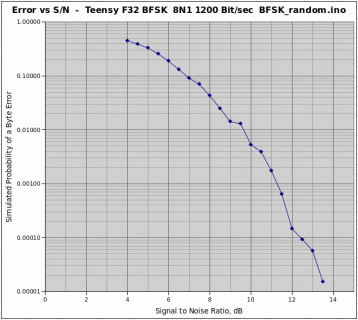

// See BFSK_random.ino for details of S/N measurement
// Signal power = 470.831299, 5625
// Noise power = 471.335632, 5625
// S/N in dB for S set to 0.414476 and N set to 1.0f: -0.0046
// S/N=7 dB marginal but S/N=14 dB is solid
snrDB = 14.0f;
modulator1.amplitude(pow(10.0, 0.05f*(snrDB-7.65f)));
