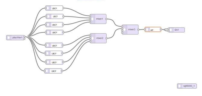

Dear all,
I have written the two building blocks of the freeverb algorithm
as defined in https://ccrma.stanford.edu/~jos/pasp/Freeverb.html
(I basically edited Paul's biquad filter code, as Paul himself suggests).
Installation is very easy : you should add the two lines :
#include "filter_lbcf.h"
#include "filter_ap.h"
to your Audio.h file and add the four files filter_lbcf.* and filter_ap.* to the directory where Audio.h resides
I add an implementation of freeverb
and show the topology (of course these are not objects of the gui so this is just for demonstration)
but of course other topologies are possible
as in http://www.mathworks.com/examples/matlab-dsp-system/2338-adding-reverberation-to-audio-using-freeverb-algorithm
which allows some control.
*my example requires that you have the sample audio files on the sd card
and of course that you have an sd card present...
enjoy and please share your comments

improved example
I have improved my example to include a "wet" and "dry" mix and
I increased the number of LBCF to 16 as originally intended (8 for each channel)
and also 2 AP filters.Some samples sound good but I feel that it takes its toll on the processor
so you should play around with the parameters - amount of mix, value of g etc.
again this example uses the sd card and sample files on the site, it should be
quite easy to change the input to analog input. By the way if you are interested
in a distortion effect the LBCF alone can produce this with some setting
of its parameters (found it by accident but cannot reproduce now)

@Avi Harel: I've been playing around with your freeverb code (nice job!) but I've found one problem. In setup of freeverb4 you set the levels for mixer4 twice. I think the second ones should be mixer7 which mixes the wet and dry signals.

Also Avi Harel: The free verb all pass are supposed to be all pass delays, not all pass filters. They are basically a delay line with the input subtracted from the output. I will find you a reference. Its nice to have an all pass filter implementation also though! Love me some all pass filters, but they aren't very useful on their own, mostly useful in feedback loops.
I've added a Freeverb implementation. I worked with this code for a while, but it seems to suffer numerical range issues. Use of the biquad code also isn't ideal. In the end I went back to the original freeverb and created a new fixed point version as a single object which scales the data.
https://github.com/PaulStoffregen/Audio/commit/1b69ff6c1746432150cf0af213f6dec4807ebb77
It consumes about 22K of RAM and uses 9% CPU on Teensy 3.6 at 180 MHz.
Later today I'll work on the stereo version and adding the adjustable parameters and documentation....
