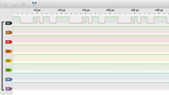

I’ve been doing frequency modulation with a Teensy 4.1 using interrupt code. I modulate a 1khz sine wave on a 40khz carrier by looping through a series of timer frequencies in an interrupt that reconfigures the timer after each cycle. I’m having to dig deep on STM32 DMA, and ran into a set of features that would let me do the modulation without the interrupt code. I'm newish to DMA usage and I suspect that the Teensy 4.1 can also use DMA to loop through a ring buffer containing the timer values and auto load them into the timer’s configuration register. Can I get a code fragment that would do this?
I did something similar for the SmartMatrix library. Not sure if this is exactly what you need, but it uses DMA to update the timer registers with each cycle. I would recommend reading through the FlexPWM chapter of the reference manual - it has lots of extra features that might be useful. Here is a sample sketch.
// Sample code that demonstrates arbitrary pulse chain generation using FlexPWM.
// Each pulse triggers DMA to write new data into the FlexPWM registers which takes effect on the next pulse.
// This allows independent control of the frequency and duty cycle for each pulse without using interrupts.

  // Generate a DMA trigger at the beginning of each cycle (when the signal goes high)
  // This is used to trigger DMA transfer to reload a new period and duty cycle into the registers, which take effect on the next cycle.
  flexpwm->SM[submodule].DMAEN |= FLEXPWM_SMDMAEN_VALDE;  // enable DMA trigger at cycle start

  // configure DMA transfer
  // timerUpdateDMA updates two FlexPWM registers from the timerVals array.
  // The source address reads from timerVals[x][0], then timerVals[x][1], then moves to the next index.
  // The destination address writes to timerRegisterPeriod, then timerRegisterOnTime.
  // A minor loop offset is used to reset the destination address after each transaction.
  // When all iterations are complete (all pulses have been output), the source address is reset to the beginning and the process repeats.
  minorLoopIterations = 2;  // number of registers to update

Here is the output (configured to make a repeating chain of 4 pulses):
