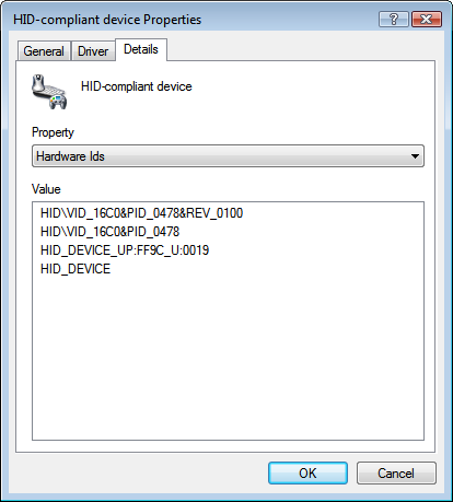

Lastly: is there a Windows utility to display the VID/PID (e.g., for a USB/serial from FTDI that works properly?) I'll guess FTDI has a variety of PIDs as chipsets have changed.
Yes. The Windows device manager can show you this info. Look for the drop-down list on the last tab and choose Hardware IDs.
Here's a screenshot for HID. The process is similar for nearly all devices.
