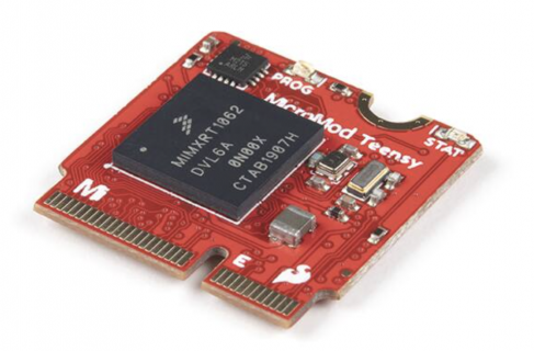

Hey folks, check out the picture upper top right in this link: https://www.digikey.com/en/maker/bl...ce-micromod-ecosystem-accelerates-prototyping (screenshot Attached). We need software like in one of those spy movies to enhance, the image but to me that looks like an actual sparkfun teensy micro-mod! I am so excited!! For many applications that require fewer than the full set of pins and where swapp-ability and PCBa board size are the driving design considerations (0.1" headers are kinda frowned upon in my world) this will be fantastic. I only hope that they also make the 3.6 and 3.2 in micro-mod form!
-john
Somebody broke embargo! Interesting. Is that an ethernet Phy I spy? (on second thought, probably not)
MicroMod Teensy <--> Teensy MicroMod
So, these are two different versions.
I have a Micromod board... didn't bother unboxing.. :) It's for the MicoMod Teensy 3.2 Luni board I didn't solder...
John: Go and find images of Teensy i.mx rt 1176.

<Enhancing image level 1000 applied> Nah, I just found this in google image search somehow. Enjoy =D.
