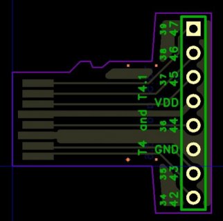

3. The T40 has solder pins on the bottom side, the T41 has them exposed as pins. As I understand it, the Teensy does not fully utilize the NXP chip. Can there be more underside solder pins on the T41 exposed? What are the limitations of the NXP chip in this respect?

2. You can with T4 and T4.1 use the SDCard pins for other things. It is easier on T4, but I also have played with them on T4.1 using SDCard adapter... I played with one on T3.5/6, which had labels for it... I have since played with an update for T4.1, but have not ordered any...
3. T4.1 has some other exposed pads on bottom, that is setup in patterns for memory chips. The startup code does try to see if it has memory or not. I have proposed a couple ways to bypass this if necessary, but if you are not using external memory (either RAM/ROM), these pads can be used for something else, like SPI2... The new T4.1 page/card has more info on these pins: https://www.pjrc.com/store/teensy41.html

6. SD Card port pins are setup to be used...

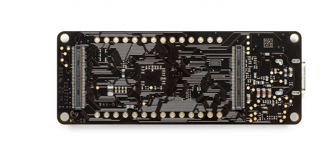

I really like the connectors of the Arduino Portenta. Having regular pin headers on the side and 80 pin high-density connectors on the bottom of the pcb. I really wish the new Teensy adapts this format as I want to see a teensy with more IO. Having a super fast dual core teensy will allow for much bigger projects.

I really like the connectors of the Arduino Portenta. Having regular pin headers on the side and 80 pin high-density connectors on the bottom of the pcb...
I mentioned this previously and agree it would be an optimal solution for users who have requested high-density IO buses to be brought out. It's the same solution reached by Arduino Portenta, pyboard, Rasp Pi compute module, many others.

I know at one point Paul was not overly positive about connectors like the ones used on the now retired Intel Edison...
So in order to use those extra pins requires someone to make a bigger breakout board that then brought out all of those pins (again what people did for Edison), which then we would then need another board that one plugs into that we would do our actual stuff on... Or do you see again using Edison as an example, people bringing out boards with matching connectors on the bottom, so you might have a display insert board, which then you can plug in the next board and go many levels deep?
This is exactly the problem with the high density connectors. For development boards that use them, the breakout boards are few, and they tend to be expensive. And, like you said, you end up using a breakout baseboard to attach other breakout boards to.

As always, it depends on your definition of 'expensive'. Arduino just released a $46 breakout board for the Portenta here : https://store.arduino.cc/usa/portenta-breakout
In addition to two 80 pin high-density connectors with signals brought out 0.1" center edge holes it also has:

For everyone who likes Arduino Portenta's high density connectors, I would like to ask you very specifically which other boards have you plugged your Portenta into so far? I especially want to hear about any experiences with custom made or non-Arduino boards which mate with Portenta's high density connectors.
While I don't want to nitpick minor differences, I do feel that high density connectors are not at all the same design as a card edge which mates with a SIMM or DIMM socket. Mating with a M.2 socket (eg, Sparkfun MicroMod) is probably pretty similar to a card edge for a DIMM socket.
Then there are the users like me who are willing to design a baseboard to bring out high density IO.
Have you designed any base boards for other products using the high density connectors.
it makes pluggable mounting to a baseboard much easier than it is now, with the mix of 2.54 & 1.27mm (ethernet) pin centers on the Teensy 4.1.
Having plugged Portenta into Arduino's first base board (the one with ethernet that's about the same size as Portenta), I do agree, it is a pretty nice experience. Or at least it is with Arduino's official products... and for the retail prices they're asking, you'd expect it to be a premium experience!
So far I'm not seen any 3rd party base boards for Portenta. Do any exist yet? Are any being commercially manufactured by 3rd parties? I'm particularly curious about the practical aspects of meeting the part placement tolerance for 2 high density connectors spaced relatively far apart for the boards to easily mate.
