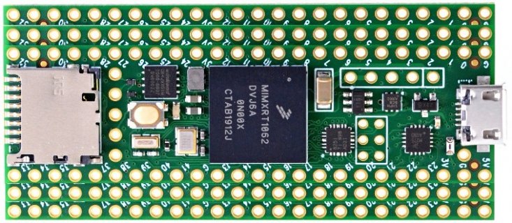

One way to expand the number of pins available would be to provide double-density castellations along the edge. The Alorium Evo M51 does this. Every 0.1" spaced through-hole pin is brought out to a castellation at the edge. Between each of those connections is another pin, for net spacing 0.05". This provides roughly twice the pin count and makes the board surface mountable.

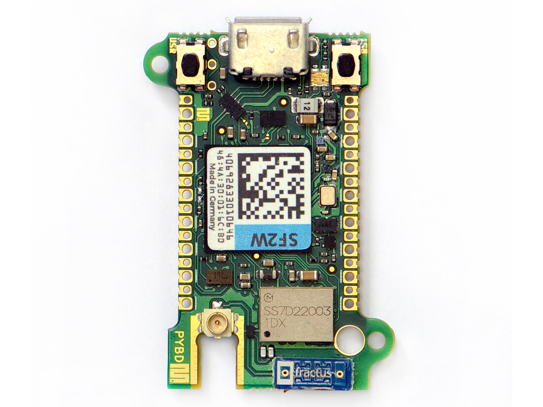

Similar idea, implemented on Pyboard D SF2/3/6 :
https://store.micropython.org/product/PYBD-SF2-W4F2

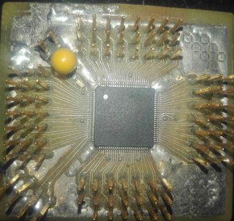

I vote for something like this (to get all pins + extra GND:s)
as homemade pcb:s with 0.15mm tracks is possible (to fit two tracks between each pin)
the ic above is a pic32mx360 0.4mm spacing (I have never used it:p)
also it's still possible to easly solder wires on three rows using perfboard.
that would make it possible to connect high pin count displays/buttons/pots
without sacrificing any valuable peripherals pins.
I would also vote for placing all essential peripherals pins
on one side (if possible) to make it even easier while prototyping.
to use the outer pins either it can be mounted on a pcb (perfboard/custom)
or double row angle headers can be used for height efficient prototyping.

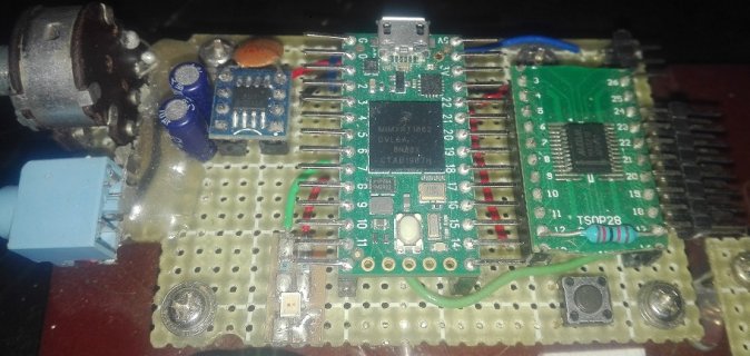

the DAC is a PT8211
and I'm using a MAX6818E for easy debouncing of the pedal buttons.

A quick note about castellations:
1) They are only useful on boards that have no bottom side components. The idea behind the castellations is to allow surface mounting the board to another board.
2) Castallated holes tend to add a fair amount at most (if not all) PCB manufacturers. Extra expenses in production must be passed on to the consumer, and I, for one, don't care to pay for something is not useful.
The topic of castellated pins has come up a couple times before in this thread. One major challenge is the decoupling capacitors on the bottom of the PCB. These would require a cut out if one were trying to solder to a baseboard.
